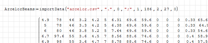

Hi Ioan,
seem there are issues with the first column (the beam type and size); I can not load the column even by enclosing the values in double quotes... except for that other data can be loaded without issues
regards,
w3b5urf3r
P.S. does anyone know the difference between the 3rd and the 4th arguments of importData(9)?

the first column can be read using ExcelRead, this works as long as the cell content is a string or an integer.
Just save the csv as xls. Turn out that ImportData and ExcelRead have complementary features/bugs.
arg3 is arg delimiter for symbolic expressions (in case arg9=1), arg4 is column delimiter in the data file.
Best regards, Martin

Hello w3b5urf3r,
Hmm...To be honest, I am not quite sure about it. I just used importData(9) and not importData(1). The letter one, importData(1), sometimes reported errors like "The input string was not in a correct format" (not sure why) and I just stick with importData(9). I understood that the 3rd argument is the decimal separator in the text file (txt,csv). I put for the 4th argumnet zero (0) without paying to much attention on it meaning that the default value of function argument separator was used. Not quite sure when the function argument separator ( either "," or ";" ) should be changed and not using the default value.
EDIT: Sorry, I just saw the explanation by Martin
WroteP.S. does anyone know the difference between the 3rd and the 4th arguments of importData(9)?
Wrotearg3 is arg delimiter for symbolic expressions (in case arg9=1), arg4 is column delimiter in the data file.

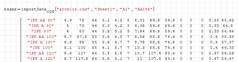

Davide Carpi 18.12.2012 18:22:00
WroteCSV converted with LibreOffice and imported with DataExchange plugin
Best regards,
w3b5urf3r
Hi w3b5urf3r,
Of course it would be preferable if SMath could handle itself a clean Excel import/export operation.
Seeing that it is not yet the case, I appreciate much your practical solution; I hope it is welcome also for others.
BTW:
I've seen that once the "arcelor" table inputed in SMath, it can be read/write, as it is (with text columns included) or modified, with SMath rfile/wfile.
Once again - Thanks
Best Regards,
Ioan
