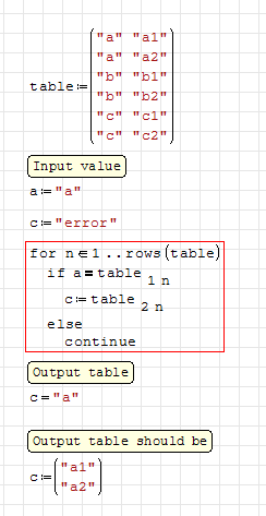

I have a question about creating a new table from existent one. A new table should be created according to matching of input value and values in existent table.
A out of operation example what I want to do you can see below.
Can you please help to solve this issue.

Dear user of smath forum

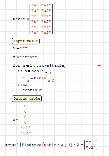

Here are two solutions
[albumimg]367[/albumimg]

Thank you the second solution is work properly.
The first solution show all rows of table, but I need just rows where input value matches with values of first column of table.
Is there possibility to improve first solution?
#4 Опубликовано: 13.03.2015 04:23:41
yes there is;
