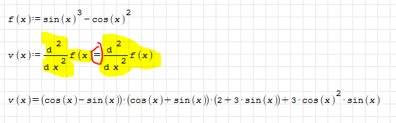

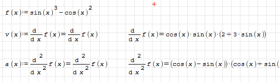

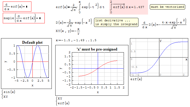

WroteAs I wrote, it is not big and not a kind it is impossible to live with it.
I am just reporting what I notice.
There is no use to evaluate the Mathcad style. On the other hand,
many direct expansion Mathcad style can't be copied for export.
Thus, the best is the algorithmic construction. On that point,
Smath is fully competent ... look @ the "Colibri" attached.

Bug confirmed. Will look at it later.

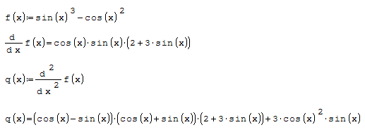

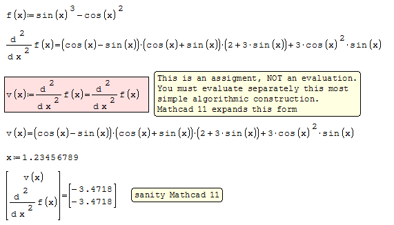

WroteJean, you misunderstood the "problem".
I accept, but in turn you must accept the fundamental
concept of transit algorithm in integration/derivation.
Good thing it is this way, otherwise lot more advanced maths
could not be done or would issue errors messages of all kinds.
... light red page 4.
Maths_0 Transit [The concept].sm (76,77 КиБ) скачан 1116 раз(а).

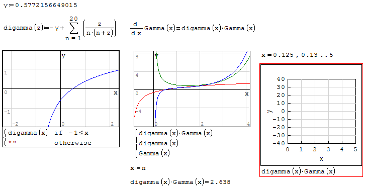

Wrotetransit algorithm
... this is another style of parametric solution.
ODE_Laplace 1rst [Type 1].sm (24,7 КиБ) скачан 1140 раз(а).

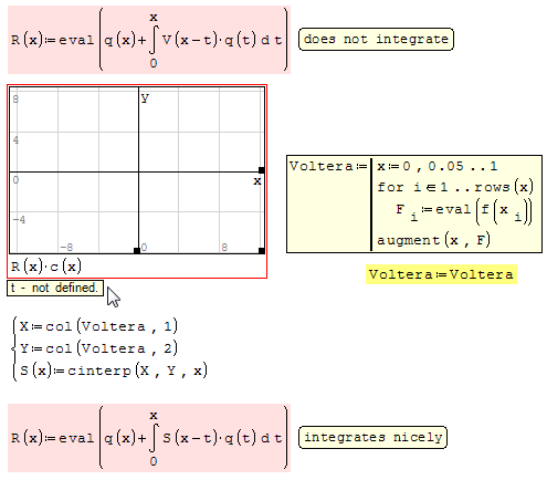

Wrote... this is another style of parametric solution.
... a much different style of transit.
At that times my brain diluted on that one !
Takes quite a while before "t_not defined"
Integrate Voltera IntEQUATION.sm (28,22 КиБ) скачан 1353 раз(а).
