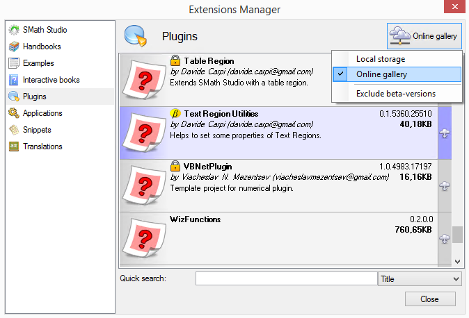

#4 Опубликовано: 06.09.2014 13:33:42
Группа: Super Administrator
Ernesto, Extensions Manager allows to update plug-ins.
Please see attached image. Select Online gallery and see the list - available updates shown in violet.
#5 Опубликовано: 06.09.2014 14:49:25
Ernesto
Ernesto
13 сообщений из 74 понравились пользователям.
It wouldn't update. I had to uninstall, as well as delete the \Users\[user name]\AppData\Roaming\SMath directory, then reinstall for it to work.
Everything is working now
