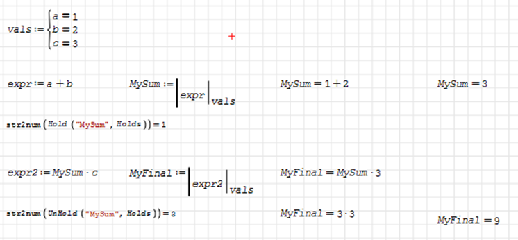

Hi, new to SMath and trying to figure how to get the formula with the variable values before the final result.
I want to write
a: = 3
b: = 4
a + b
click = and get
a + b = 3 + 4 = 7
Is this possible?

#2 Опубликовано: 23.10.2021 09:04:36
I want to write
a: = 3
b: = 4
a + b
click = and get
a + b = 3 + 4 = 7
Is this possible?
Thks

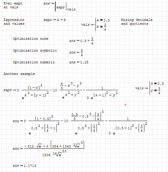

Not how you wanted in single line but possible.

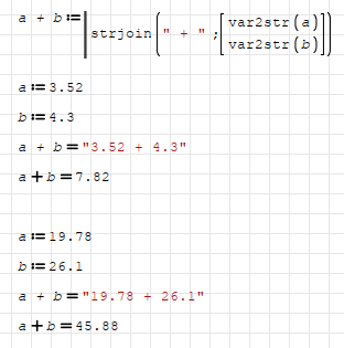

Hi. This is another way.
intermediate_results.sm (14,4 КиБ) скачан 1257 раз(а).
That looks exactly as I was looking for ... going to study it. Thks a lot, it will save me quite a bit of time.

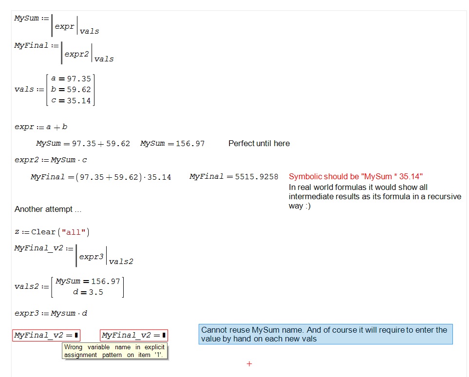

Hi Razonar,
it works perfectly well for initial formulas, but cannot find any way to use a previous result on a new one.
Cannot put all values in a single vals, the simbolic substitution will show in the second formula the formula (not the value) of the calculated value (ee).
Cannot either reuse names.
Any idea?
#9 Опубликовано: 24.10.2021 22:10:44
Any idea?
I have an idea, if someone has better you can use it.
Rewrite expressions and hide them inside areas.
Configure page setup with "no areas".
When you save as pdf or print, it will show as continuous.
MySum.sm (8,16 КиБ) скачан 1232 раз(а).
But here is a humble suggestion.
SMath was not coded with intent to show intermediate results.
You are going to struggle very much with this approach.

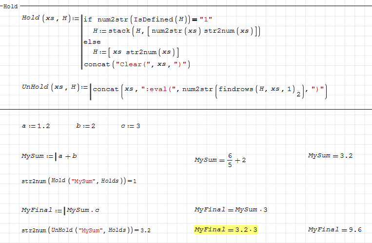

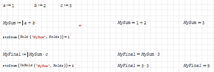

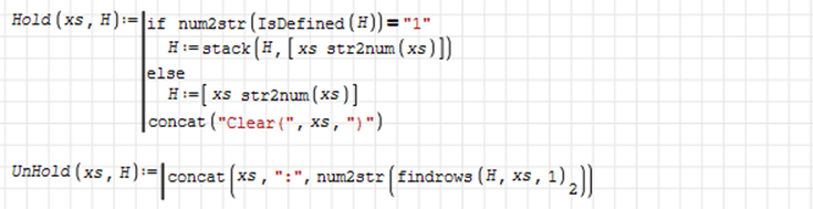

Hi. This is another way. The feature request actually is here.
Using
You can get
Hold.sm (9,78 КиБ) скачан 1231 раз(а).
or
Hold_v2.sm (9,06 КиБ) скачан 1230 раз(а).
sergio 25.10.2021 14:18:00
#12 Опубликовано: 25.10.2021 18:31:25
DeepButi
DeepButi
0 сообщений из 7 понравились пользователям.

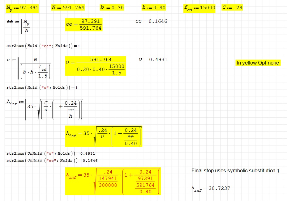

Too easy to be true Final step uses fractions to substitute ... Use a:=1.2 in your example and you will see.
Actual formulas are for sure more complex so the data display is really confusing.
#13 Опубликовано: 25.10.2021 21:06:10
Hi. Insert eval( ) in UnHold
#14 Опубликовано: 26.10.2021 05:48:01
DeepButi
DeepButi

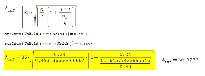

You are a genious. Thks!
Just trying to figure out how to avoid too many decimals now
Decimal places set to 4 everywhere
#15 Опубликовано: 26.10.2021 12:21:13
Hi. Thanks! ... but ... not ... but thanks. That behavior seems to be a bug or an oversight: set the decimal places in the output of an expression with None Optimization.
In the meantime, this could be a workaround, but could be dangerous, because change the stored value. Actually I don't really recommend it.
Ok, ok. Really it's a BIG THANKS.
:round(eval(... works perfectly well
:eval(round(... didn't.
