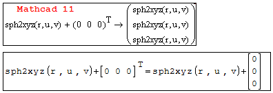

Probably just informative.
As it looks Smath does not comply to this rule.
It may just be a Mathcad/Mathsoft rule ?
#2 Опубликовано: 16.06.2017 09:16:44
Hi Jean,
this is because the function sph2xyx might returns a scalar as well as a matrix. Vectorize should do the job, though.
