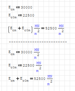

I have problem with the units.
Very simple example
What to do that the result is 52500 MN/m2
Any help is appreciated.

You are adding two unitless variable and expect result with unit, which makes no sense.
Either multiply addition with unit; or assign units to variables in first place.

Adding the units
(E.cm+E.c0m)*'MN/{'m^2}
was the thing I missed.

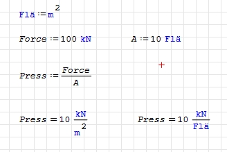

I Tried the following:
KiN:'KN
Flä:'m^2
Force:100*KiN
A:10*Flä
Press:Force/A=10*'KN/{'m^2}
That looks the way I want.

Hi. I'm not sure if this comment helps or not, but it's confusing to me the way that you introduce KiN. Notice that 10^3 newtons are 'kN in SMath and 'KN it's "undefined", even it can be used as unit.
Also you introduce another unit, or something like that, as Flä.
If you want to show your result as kN/m^2 or kN/Flä the usual way in SMath is using the "unit placeholder" at the right end after the evaluation with equal:
