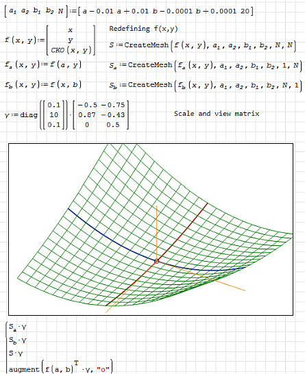

I have two 2D plots, but not one 3D plot with the minimum point.
Help please!

Hi Valery. This is a way.
6-1-Mister-Class.sm (27,39 КиБ) скачан 1374 раз(а).

Hi. Choosing CKO as z and using small ranges.
6-1-Mister-Class 3D.sm (41,91 КиБ) скачан 1389 раз(а).
