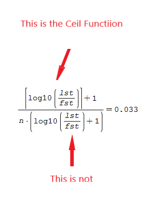

Is there a way to make SMATH expressly show the Ceil and Floor function? They collapse them to simple brackets as shown in the following figure.
Is there some setting to change this?

I don't know of a setting to change it, but you could define another function as a wrapper. See this pic:
