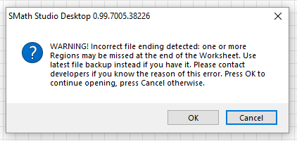

Related improvement introduced in build 7005: when SMath Studio detects similar errors it now shows the following message:
Program shows only available content if user presses OK.
