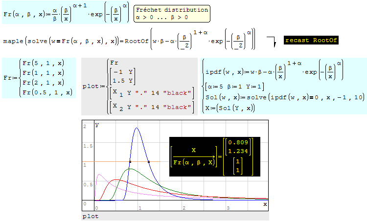

Inversing/solving a function may come in 3 forms
1. Explicit NASA(h) ... Frechet
2. maple RootOf as single/dual solver
3. LambertW [Gumbel, mostly arithmetic expressions]
This document extends Lambert dual branches [exemplified]
As it looks from recent years it has immense applications
Just schemed in this first brew. If you have more applications ... welcome.
Solve Inverse Symbolic Suite READ First Copy.sm (282,22 КиБ) скачан 1465 раз(а).

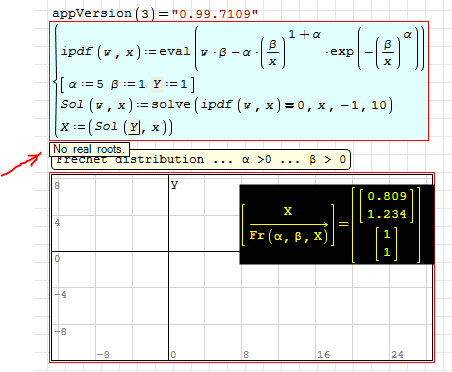

Hello Jean,
It seems something was wrong here - "no real roots".
#3 Опубликовано: 24.07.2019 21:17:28
"No real roots" SS 7109 is a bug wrt that version.
Surprising it does not complain elsewhere the solve bloc is called ?
The attached is SS 6179.
Salut Radovan, thanks for reporting ... Jean.

α, β were consumed in the Pt100 thermometer.
Solve Inverse Symbolic Suite READ First Copy.sm (289,33 КиБ) скачан 1450 раз(а).
#5 Опубликовано: 24.07.2019 23:32:40
... Fréchet & Gumbel have been doctored.
Maple failed the two Lambert branches for Gumbel.
Solve Inverse Symbolic Suite READ First Copy.sm (293,13 КиБ) скачан 1392 раз(а).

Hello Jean,
Hmm...I am not sure if it should be this way but this has been working to long.

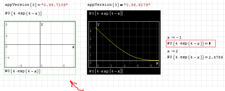

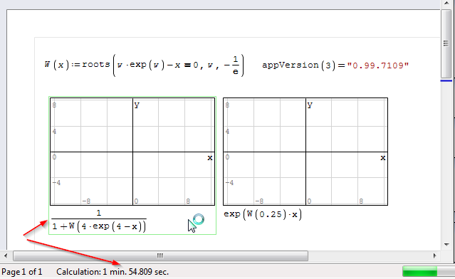

I just opened the worksheet and it seems that it get stuck at this graph.
The SMath version was 0.99.7109

You are right. It does not make sense.
New worksheet, the same situation. Tried on Win7 and Win10
Could anyone else confirm this please.

#10 Опубликовано: 26.07.2019 08:54:19

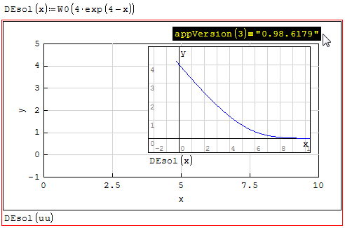

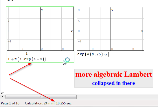

The problem is that W(4*exp(4-x)) returns an error "index out of matrix bounds" if x is negative (check it on the canvas). Then this triggers the infinite calculation time in the 2D plot.
#11 Опубликовано: 27.07.2019 18:27:24

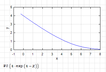

Solution of this demo DE is wrt Lambert W0(x)
I attempted W1(x) "Division by zero"
On the other hand: Lambert [W0(x0, W1(x)] do not vectorize
but tabulates for loop discrete. Wait and see Radovan next visit.
roots_solve test.sm (18,39 КиБ) скачан 1334 раз(а).

I simply do not understand why is this happening (triggering the infinite calculation time in 2D plot) and think that in 7109 this behavior is wrong regarding the 2D graph.
I think it should be considered a bug. If the x-y point can not be calculated it should be just skipped, nothing else. I also think that in 6179 is applied that behavior. The X-Y plot is doing this just right.

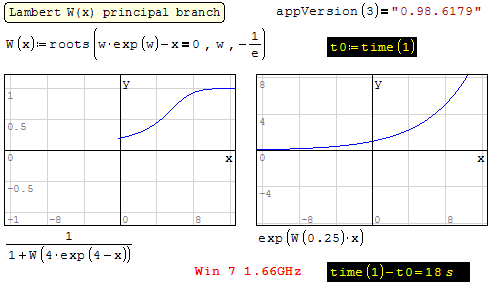

A desperate case: Quick plot 6179 just fine
X_Y red does not solve "roots" on its own canvas.
Interesting but does not cut the mustard yet .

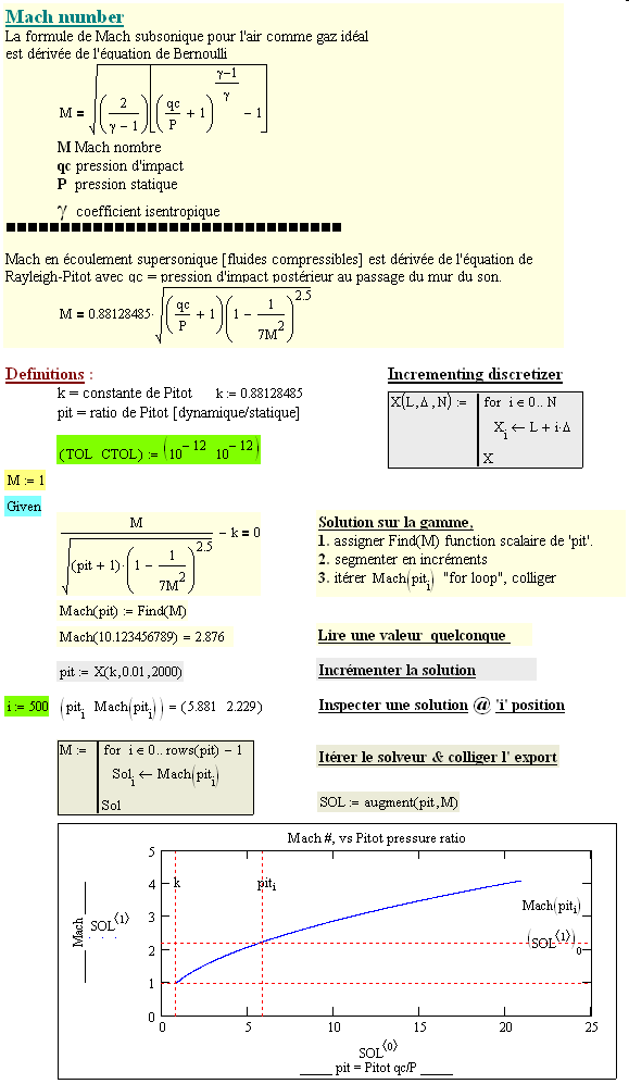

Yes Radovan but so gorgeous solving on the running canvas.
Something like Mathcad 'root', much easier to implement.
Inst_Mach Number Pitot.sm (187,41 КиБ) скачан 1374 раз(а).

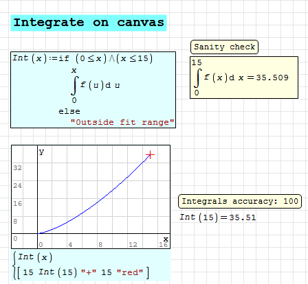

Function roots() will do the job in this example. But Mathcad root() function will not let you down in the case of srict numerical cases (I am repeating myself to often...).
By the way, there is an error in Int() function (z not defined). I think this was also already mentioned few times...
#17 Опубликовано: 29.07.2019 08:37:58
Quite right Radovan, transit via 'z' not needed 6179.
Pitot Mach was one of my very first SS 5346.
#18 Опубликовано: 29.07.2019 10:42:06
Function roots() will do the job in this example. But Mathcad root() function will not let you down in the case of strict numerical cases
Mathcad 11.2a "root" works same as Smath "roots", plot on scalar canvas.
I may have an example, considered useless compared to assigning Given/Find
lot more universal for about any project ... all done perfect.
Attached Mach-Pitot
