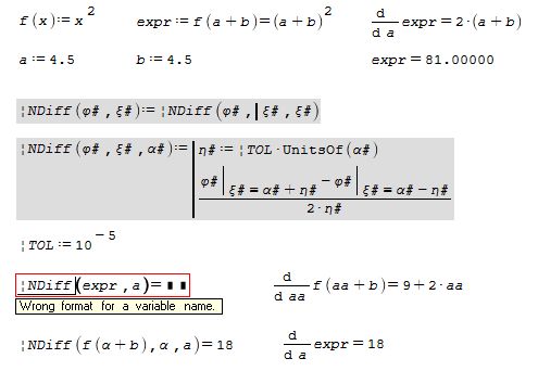

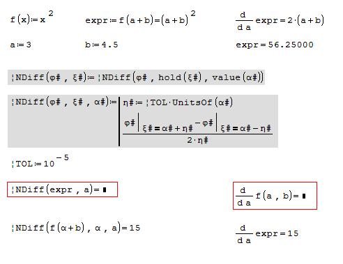

SMath doesn't have a discrete uneval function of which I am aware. However, you can replicate that functionality depending on when you define the variables. Look at my example below. uneval.sm (3,31 КиБ) скачан 1703 раз(а).
#3 Опубликовано: 02.02.2018 13:00:04
Hi. Thanks for the tip. But isn't enough for somethings more or less basics tasks, like call NDiff with 2 args, and not 3. Also, there are something else wrong about diff and how it handle some cases.
uneval.sm (8,16 КиБ) скачан 1682 раз(а).

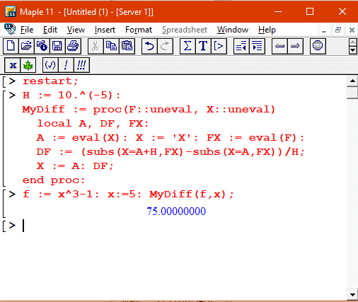

The problem with your two argument function is that you're using hold() and value() functions in function call and those functions aren't defined anywhere.
uneval (3).sm (10,68 КиБ) скачан 1649 раз(а).
Sure, I'm requesting them.
You could also use the method Jean suggests, by calling ...
Jean's method is close, but not enough (actually it's equivalent to x='x' in the image). Can you replicate this Maple's code in SMath?

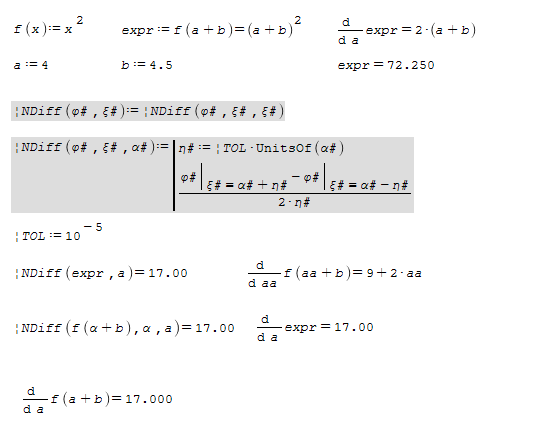

Isn't this pretty much what you want? Magics of the line operator.
uneval_Kr.sm (8,6 КиБ) скачан 1627 раз(а).

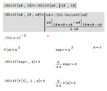

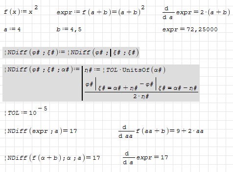

I forgot this one:

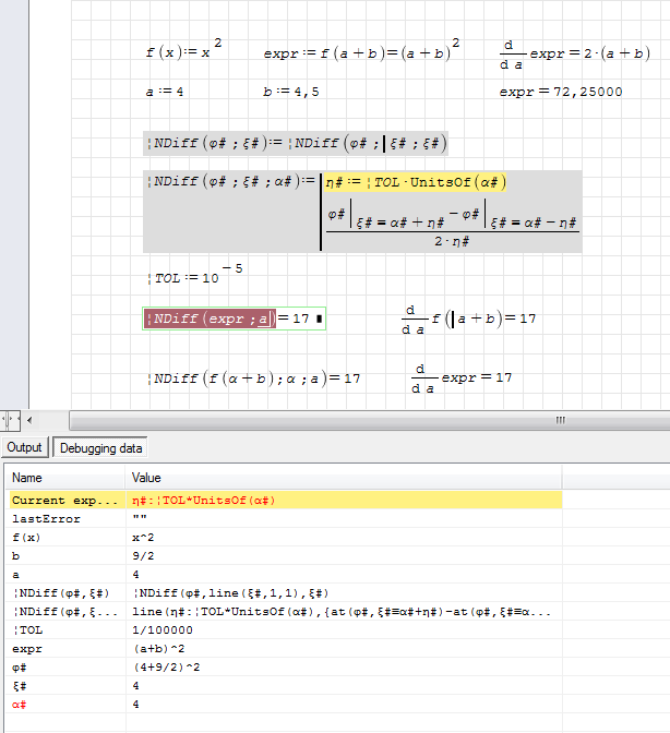

#12 Опубликовано: 02.02.2018 18:03:17
1 364 сообщений из 2 279 понравились пользователям.
Thanks Martin!
I learned something new today. Looking forward to trying some more of these tricks with line operators in my own applications.
I wish I could explain this.
The debugger doesn't seem to reveal the secret:
frapuano 02.02.2018 18:23:00, Alvaro 02.02.2018 21:07:00

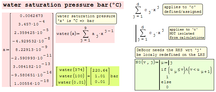

#15 Опубликовано: 03.02.2018 00:08:01
The line is a local definition operator.
Observe the red example: coefficients 'a' exist/defined/assigned
thus satisfy the Σ . On the other example |Σ 'c' result from calculations.
The summing operator must "steal" the 'c' via the isolating local line operator.
Differently but of same nature, DeBoor is redefined locally on the RHS.
More examples have been encountered [there was Legendre polynomials...]

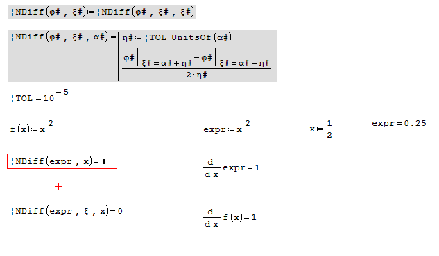

#16 Опубликовано: 04.02.2018 07:08:19

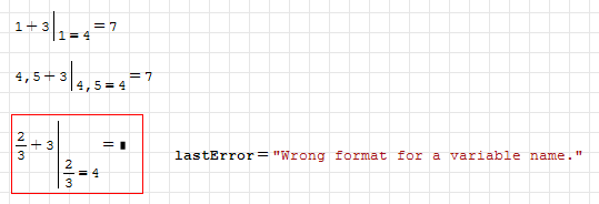

Hi. The proposed method looks excellent, but only works for integers.
So, it's a bug or what else?
#17 Опубликовано: 04.02.2018 08:47:22
The at() function used for applying the perturbation makes a search and replace without limiting the search expression to valid variable names. It can't, however, handle expressions as replacement targets.
The line function isn't at stake here.
Alvaro 05.02.2018 18:35:00
More generally, the line operator is the program operator.
It may be as short as one element. Attached are three typical
applications. DeBoor is just demo, here [attached separately].
Maths Local Definition.sm (28,24 КиБ) скачан 1668 раз(а).
Spline De Boor [Colibri].sm (33,42 КиБ) скачан 1475 раз(а).

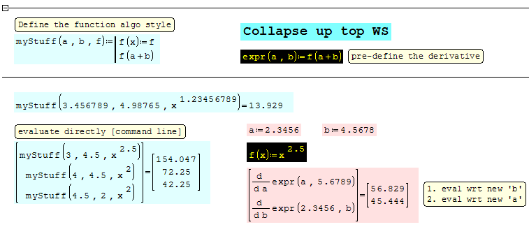

#19 Опубликовано: 05.02.2018 03:05:18
Maybe I don't understand what you are attempting,
if so => here is simple procedure that needs no
Uneval/re-eavl ... it just works on demand ,
wherever demanded in the work sheet.
Maths Uneval.sm (7,66 КиБ) скачан 1633 раз(а).
