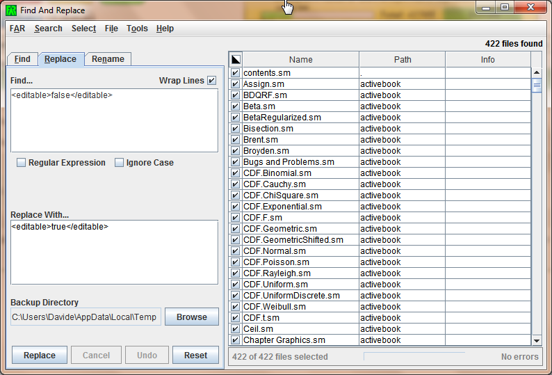

Some of these problems may be due to the fact that the external handbook pages are in edit mode. One can switch them to read only state in the file properties dialog but I am not going to do that manually for more than 400 pages.
You can do it easily using this program: FAR
Because the attribute is optional, you need to enable the at leat one time the read-only attribute manually (for new pages) or using FAR (2nd screenshot; be careful with tabs, to avoid issues copy and paste the code from a sm file)
best regards,
Davide
