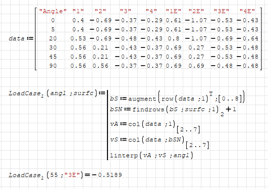

I'm pretty sure it's possible and saw it somewhere here. How do I put this in a single matrix, along with the descriptors like "roof angle, "1", "2E",...etc. and use it for interpolation. Well I can get by using a single column matrix as a work around but I guess I want a more compact looking solution, if that makes sense.

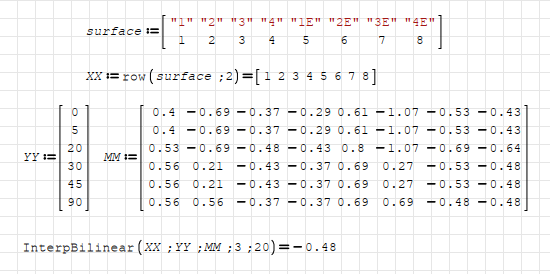

#2 Опубликовано: 17.01.2024 16:00:11
Look for InterpBilinear() function.
You can find more info in Reference Book.

#5 Опубликовано: 17.01.2024 20:45:37
Using linterp() with a function is another way.
Function selects column according to input.
linterp_select.sm (8,1 КиБ) скачан 1533 раз(а).

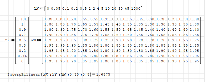

I'm quite satisfied with the InterpBilinear function. I'm exploring Jean's and overlord's additional suggestion but still it was already solved for me. Another question is that would that still work if I had to do interpolation in both the column values and row values such as in case below.
From what I understand, InterBilinear() seems incapable of doing what I aim to do. Do you have any suggestions?

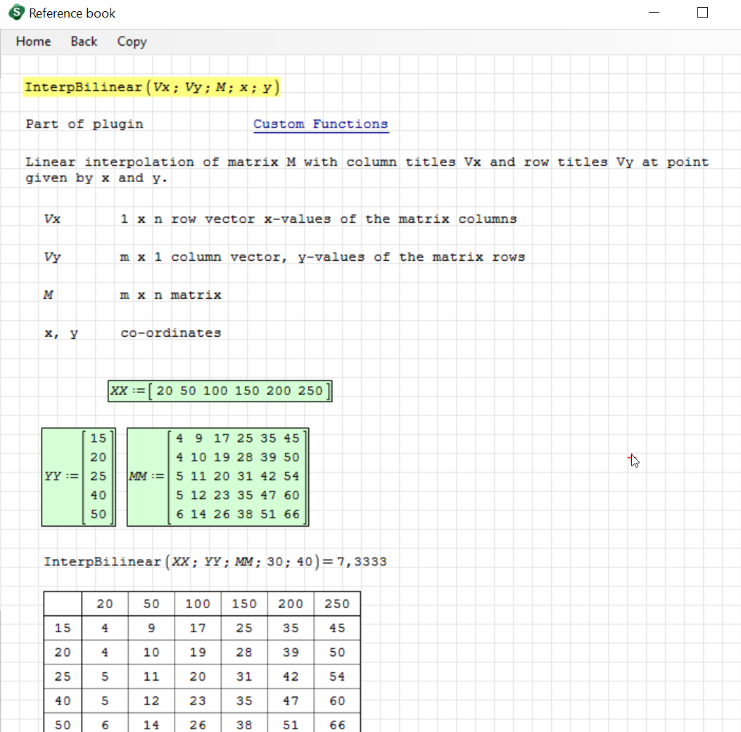

#7 Опубликовано: 18.01.2024 18:37:38

#9 Опубликовано: 18.01.2024 20:25:30
On the contrary, InterpBilinear() does exactly what you seek.
It interpolates both row and column values.
PS: I added extra values to accommodate ≤ and ≥ boundaries.
