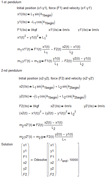

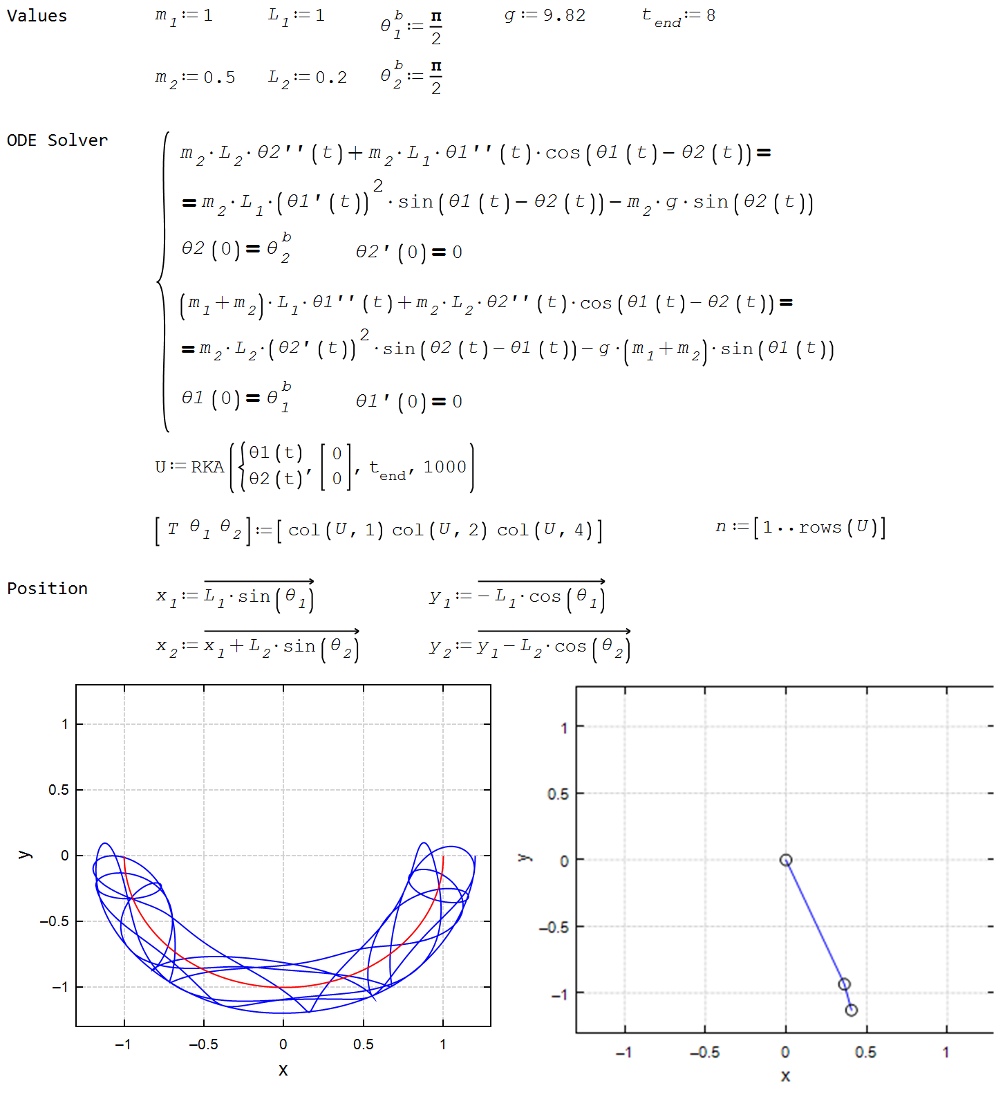

I feel the model is not correct - help please!

Hi Valery. The system is coupled. This is a way to solve it.
double_pendulum_lagrangian.sm (122,44 КиБ) скачан 186 раз(а).
double_pendulum_lagrangian.pdf (637,78 КиБ) скачан 129 раз(а).

Yes, that is correct; I previously reported on the limitations regarding the systems.
The algorithm does not currently classify the task, so issues may arise with complex problems that the current method cannot solve. It might produce a plausible-looking solution that does not actually address the problem at hand.

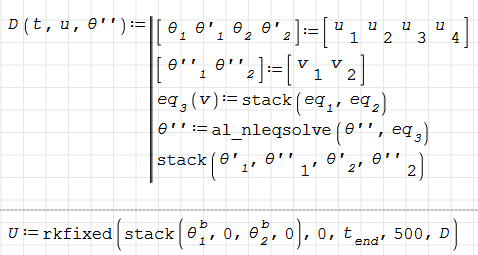

The RKA function includes the necessary procedures to solve hard coupled systems.
double_pendulum_RKA.pdf (483,53 КиБ) скачан 122 раз(а).
double_pendulum_RKA.sm (43,57 КиБ) скачан 183 раз(а).

Thanks, Alvaro!

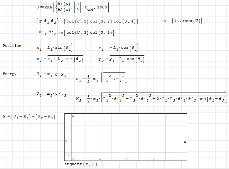

But I cannnot create five f(t) plots:
Potential energy of pendulum #1
Kynetic energy of pendulum #1
Potential energy of pendulum #2
Kynetic energy of pendulum #2
Sum of energies for the verify the model and ODEs solver. Must be const.
Help please!

Hi Valery. This is a way. You can plot the time in T versus U, K or U+K. The plot in the figure shows that the energy is constant. In this case also, the total energy is the hamiltonian.
double_pendulum_RKA.sm (49,21 КиБ) скачан 13 раз(а).

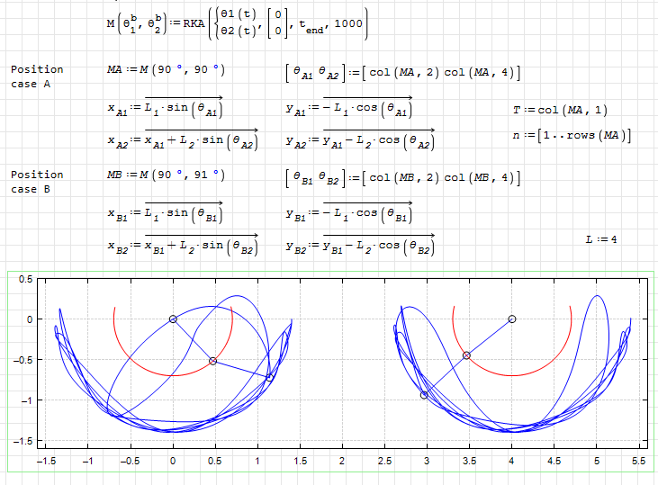

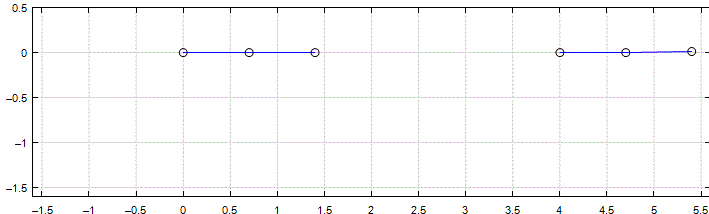

Hi Alvaro & Valery,
I enjoyed the matematical results of yours developements, without following all details.
I propose you a problem, dealing with the Butterfly Effect on a double pendulum - after some cycles, the 2 pendulums becoms distinct. Attached there is a simple gif file
Hi Alvaro & Valery,
Hi Ioan. Something like this.
double_pendulum_RKA Butterfly Effect.sm (50,58 КиБ) скачан 10 раз(а).
