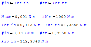

Why would you need these? They are all aggregate units; everything is already in place to define them in-place or use right away:
