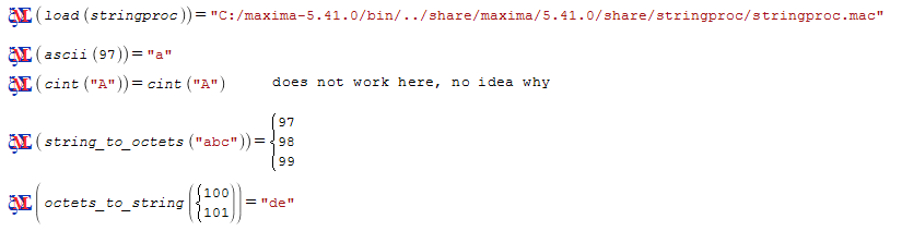

Hi
I'm looking for the equivalent to Excel ASCII functions
code("a" )=97 (space after " added to avoid a winking Smiley!)
char(97)="a"
and so on.
Does anyone know if they're hidden in a Plugin somewhere, or if there's an easy way to create them?
Many thanks
Brian
#2 Опубликовано: 17.06.2018 17:15:58
"a"
#3 Опубликовано: 17.06.2018 17:34:52
There are some conversion functions in Maxima.
ascii.sm (4,27 КиБ) скачан 1085 раз(а).

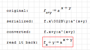

#6 Опубликовано: 18.06.2018 11:42:50
Hello.
Another example is available here: https://en.smath.info/forum/yaf_postsm47084_SMath-Studio-0-99-6617--12-February-2018.aspx#post47084

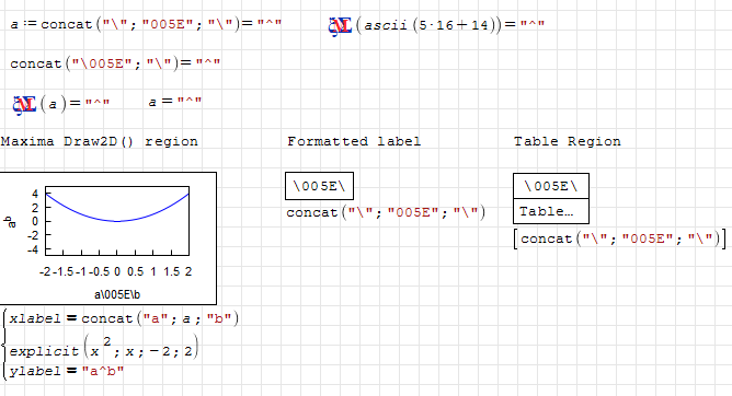

There seems to be something special with the characters generated this way. They will be backconverted to code sequence if used in Maxima region, label region or table region.
Zeichenketten.sm (57,75 КиБ) скачан 1016 раз(а).
#7 Опубликовано: 18.06.2018 12:25:29
Now I know why cint("A" ) does not work. It is a translation problem from SMath to Maxima, see SS-3543.
#8 Опубликовано: 18.06.2018 12:29:10
They are special indeed, you can see it by exposing the plain text with copy/paste... The syntax is handled at code level by the math region (like a bbcode or a markdown text)
#9 Опубликовано: 18.06.2018 12:50:19
This is strange. I understand that the \xxxx\ markup can be convenient at input time or if the characters are generated from computed codes. But why need they to be stored this way? SMath can store and display the corresponding symbols directly.
I'd vote for an instant conversion and storage as unicode character, at least for those which actually can be displayed.
This would be closer to the paradigm "what you see is what is done".
frapuano 18.06.2018 13:46:00
#10 Опубликовано: 18.06.2018 14:06:19
Because many characters are taken by the math syntax... +-*/.,:;<>(){}@#! (and many more)... converting the code in character may cause trouble while reading back the code.
