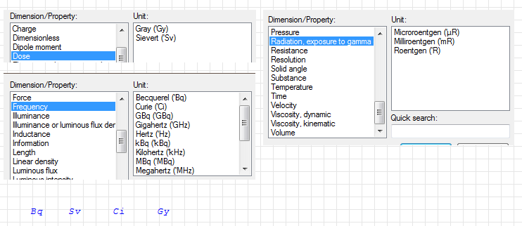

Has anyone added units associated with radioactivity - Bq, gray, Sievert, curie, dpm, dps, etc.?
XML files and I do not get along.

Not all are missing
Those that are not already built in you can define yourself: 'dpm:=Gy/min
