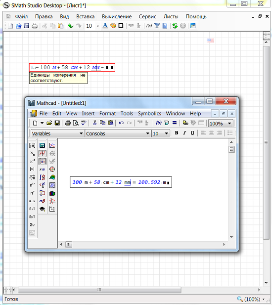

Why this not working?

#2 Опубликовано: 11.07.2014 03:36:24
because of caps?
[albumimg]354[/albumimg]
#3 Опубликовано: 11.07.2014 03:42:26
I use russian units. They do not work. I don't know is this a bug or not. English units are working fine.

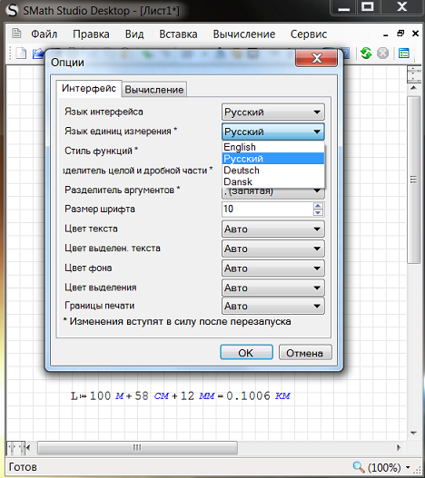

#5 Опубликовано: 11.07.2014 04:40:15
Thank you Radovan, now it works fine (default was English.).

#6 Опубликовано: 11.07.2014 04:45:24
Thank you Radovan, now it works fine.
Uni, I do not understand . I can not use my languages in this build (neither Serbian Latin, nor Cyrillic) and if you and other people can do this, this must be my computer fault. I will try on some other computers to see if the problem persists.
