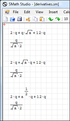

I was just playing with the software and it looks promising, but I cannot say that it is reliable right now. While checking out differentiation option I found an error. On the screen you can see 3 different calculations and second one gives wrong result.

Hello. Thank you for the report.
This error in symbolic module of the SMath Studio was already found and fixed:
New version of the program will be available on the end of February.
