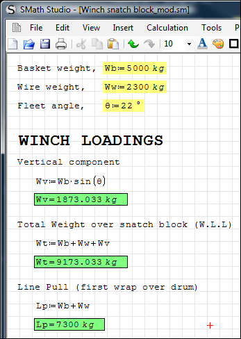

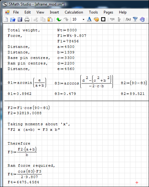

rosswhittingham, I've checked your examples.
Here is what I get with a latest SMath Studio build (I've modified your files a bit):
Figure 1: Winch snatch block_mod.sm
Figure 2: aframe_mod.sm
About errors you found in SMath Studio 0.88. As Radovan said it is due to the Angles option - please check this topic out for details. Actually bug is fixed but I really recommend you to use degrees Unit instead of the global angles option (also see the second post on that topic by Radovan). The second problem you've mentioned about imaginary part after using inverse trigonometric functions - this is an accuracy error and this is also fixed in SMath Studio 0.89 as you can see on the pic above.
Best regards, Andrey Ivashov.
P.S.: In the aframe.sm file you use Units, but this use case is very strange... check out the first screenshot to see how Units should be used normally.
P.P.S: Zip-archive with all related files: for_rosswhittingham.zip.

Morning Andrey,
thank you very much for you attention to this, when i try to open the files i loose a bit of formatting due to my earlier build, but the end result works just fine when in radians mode.
the unit function is something i just noticed yesterday, i just assumed it was just a quick way to enter labels, i did not realise you could actually 'give' the number its unit as it were (i need to read up on this on the wiki, looks great)
