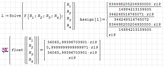

Solve() from the Maxima plugin can handle under-determined systems of equations. In such cases, the solution contains a free variable. The name changes every time the sheet is recalculated. If you want to rely on that name, insert a MaximaControl("restart" ) command to reset the Maxima session and the counter.

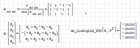

Writing the system as a linear one, SMath have some functions for work with those systems, like this one
Trial.sm (61,84 КиБ) скачан 1657 раз(а).

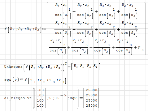

For your f(x,y,z) ... I get two sets of solved [x,y,z].
Smath solves the Mathsoft example, 4 unknowns.
Smath Butller is lot more advanced/difficult.
Jean.
Solve FindRoot f(x,y,z) ITERATIVE.sm (103,87 КиБ) скачан 1809 раз(а).
