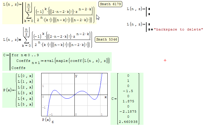

there are known issues with the iterator name of functions like sum, if that variable was previously defined; just clear it before using inside sum.

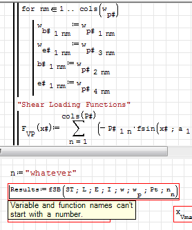

Clear() is the most reliable way to act, and won't change the logic of your function even when this issue will be solved
2. Where is 'n' being defined in the original function?
In the for loops before the sums. Try it on the canvas, the iterator variable is available with his last value outside the loop (by design).
Or do I need to clear(n) before every sum?
before any sum in which you might not have the control on what is defined before; In this case, the first sum() inside the function, whatever you use or not use n locally, because n might be used on the canvas. If you still want to use n in amid of 2 sums, you have to clear it again before the second sum. However if you forget it the error status shows that something is gone wrong.

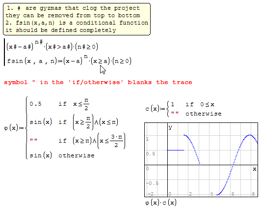

Please, check the attached:
1. Not a case of clearing anything
2. Changed the nSum for mSum
3. Removed all gyzmas #
4. NO error message
I understand nothing in that kind of work,
but results make sense even with units.
Simple Beam - Copy.sm (63,58 КиБ) скачан 1267 раз(а).
