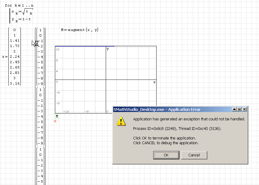

When I got the range of t below zero SMath crashed.

In the definition of y, note that the subscript k is missing. Upon hitting enter, SMath crashed.

Crashing occur at my computer as well, as soon as I insert the matrix M in the plot :

Same file as above. Was just modifying the example. Seems to be an issue with t generating a large result as an exponent. If I constrain t to be -3 <= t <= 3 every thing works.

The crash occurred when I accidentally typed -44 instead of -4 as the lower bound on t.
