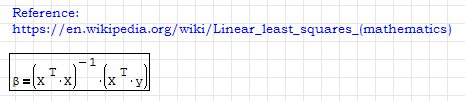

I was reminded by the posts in, New variable programmatically; also: Solving under/over defined system of linear eqautions,
that I'd recently used an algorithm for overdetermined systems that I'd unearthed in Wikipedia:
I've documented it's use very simply so that even I'll know how to use it next time it's needed. (memory gets a lot worse with age
) Perhaps others will find it useful.
https://smath.com/wiki/GetFile.aspx?File=LinearEquationSystems.sm
Brian

Thanks alot; always good toclean up a worksheet from unnecessary plugin calls.
The β snippet represents the 'Cholesky' solver, used directly
for fitting polynomials to noisy data set. It is also the basic
solver in association with the "Conjugate Gradient".
