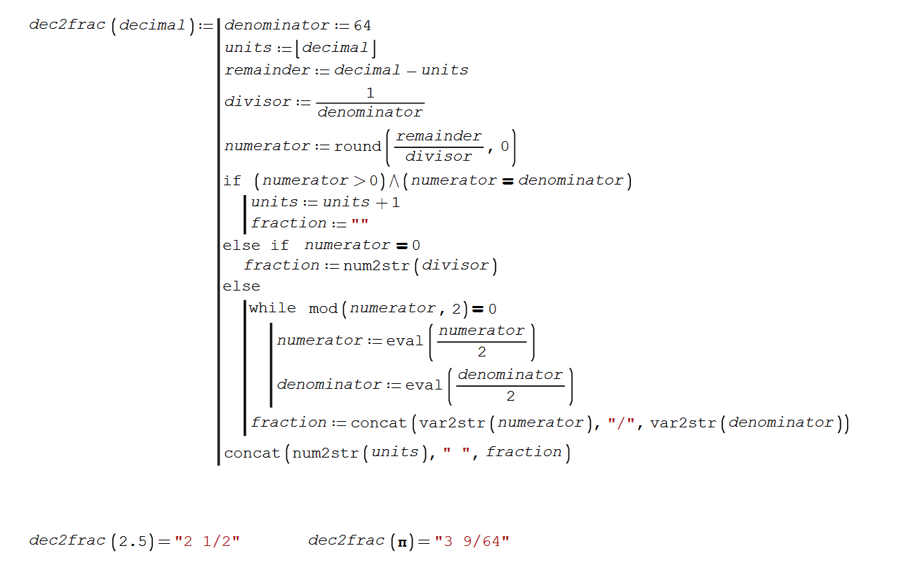

Natural fractions. How can I enter a value to display the integer and fractional part, like 2½. Maybe somewhere there is a full-fledged Help?

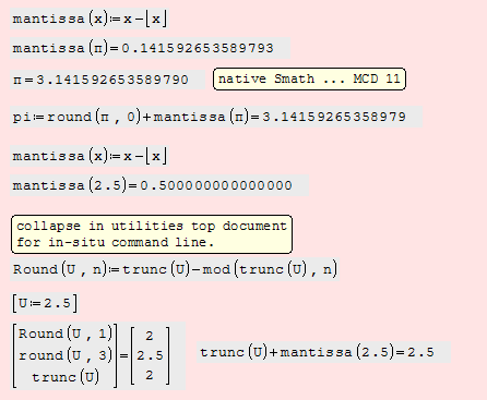

Natural fractions.
... Maybe like this

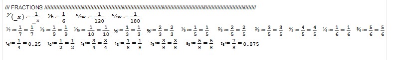

Greetings!
I understand your question, but such a feature isn't built into SMath. However, there are ways to mitigate this lack of support.
If you wish for special characters (e.g., 「½」) to be treated as a number, you can declare then as such:
½:0.5
      There are a few of these fraction characters you can define as a variable:
If you wish to type a fraction in as you propose (2½ ), this isn't so easy. You can use a matrix and then add the values together (i.e., Σ[2 ½]). This reads kinda like a fraction, but is needlessly bulky:
sum(mat(2,½,1,2))
If the goal is to have the result of 2.5 itself to report as 2½ instead of 5/2; there isn't much you can do. The one thing you can do is create a function that will convert your number and report that fraction as type "string"

Natural fractions.
... make it algo style utility.
Maybe this can help:
dec2frac.sm (6,59 КиБ) скачан 1316 раз(а).

Natural fractions.
... lat brick in the wall from not acknowledged.
Stuff Forum.sm (12,14 КиБ) скачан 1371 раз(а).

"dec2frac(decimal)" Works for me! Thank you! I've been using a sheet from MathCad, which is not as clear:
