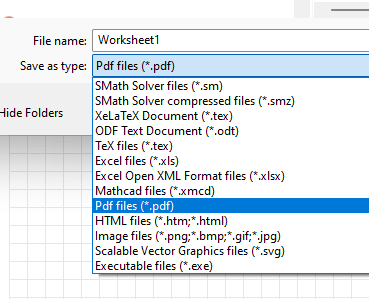

#4 Опубликовано: 07.10.2023 10:38:03
Basile
Basile
8 сообщений из 172 понравились пользователям.
Save As
Select *.pdf
Hope it helps,
Basile

I can't see pdf anymore in "save as"

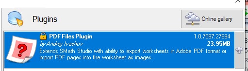

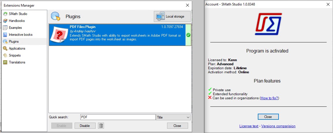

Greetings,
With the evolution of SMath's EULA, those supplementary plugins created by Andrey are no longer available to Basic accounts (Please take note of the "Locked" icon):
This plugin can still be used, but it is limited to user accounts with Extended Functionality:
It is possible in the last upgrade you made to the SMath Studio; you 'lost' the permissions to use the 「PDF Files Plugin」 if you don't have an activated account.
Solution:
- Upgrade/activate your Smath account to access this plugin.
- Use the "PRINT" command and select a PDF driver (which typically comes installed with your PDF application (e.g., Adobe, Nitro, Bluebeam, etc. )
