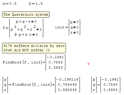

This bug is strictly Smath 6179.
5346 didn't suffer the undefined binary '0'.
Bug 6179 Zero.sm (9,96 КиБ) скачан 1273 раз(а).
#2 Опубликовано: 29.12.2016 21:20:48
This is a known problem of Nonlinear Solvers plugin wrt SS 0.98; in this case the next version seems working fine:
