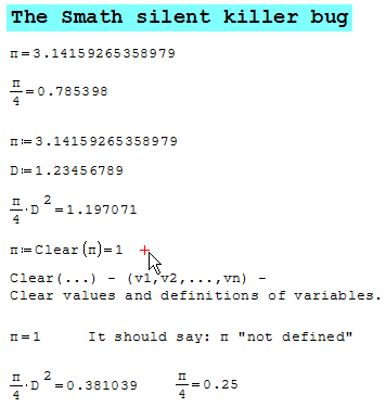

#4 Опубликовано: 31.03.2016 22:22:27
Please don't reply: do this, do that
Smath does NOT do first, I don't have to do what it should do.

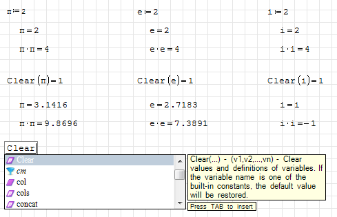

Jean, thank you for pointing out the different behavior of Clear about built-in constants. My fault, was in my knowledge and I've forget to document it.
I've updated the plugin (SS 0.97.5346 and later), now the description of Clear(...) reflects also this behavior.
