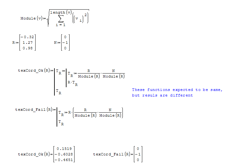

Here is in attachment files illustrating wrong computation of local variable.
Using version 0.98 (build: 5935)
bug.sm (7,04 КиБ) скачан 1379 раз(а).

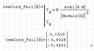

Mike Kaganski
Mike Kaganski
Seems that it incorrectly optimizes the order of evaluation (despite brackets explicitly set).
This looks like a bug.
Aside, please note that this may be simplified like at the top of the screenshot.
Submitted SS-2340
A workaround:
And BTW, you may rewrite your Module() like this:
because scalar multiplication of vectors is sum of products of their corresponding elements multiplied by cos of angle between them - and for identical vectors, cosine is 1.
С уважением, Михаил Каганский

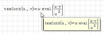

#4 Опубликовано: 09.05.2016 22:38:11
Define as function for greater functionality/elegance.

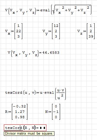

Jean,
Are you using matrices curved lines?
I get squares.
Thanks,
Basile

Jean,
Any idea why does not evaluate but gives error message?
Basile
#8 Опубликовано: 12.05.2016 00:08:22
Jean,
Basile
...as it looks there is a pair of missing brackets in eval(,)
