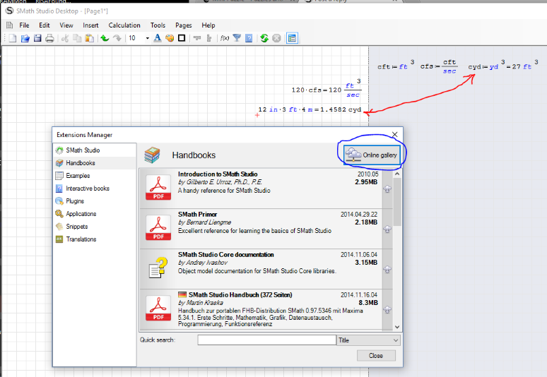

#4 Опубликовано: 24.12.2015 17:02:21
Dionysios J. Pantazis
16 сообщений из 179 понравились пользователям.
did you look at the handbook or links to learn SMath?
-> Tools-> Plugins -> Handbooks
You might want to download some of the online info too.
units- you can always define what you need in a worksheet if you need-
