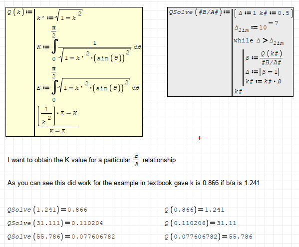

Good day everyone,
I am building a Hertzian stress calculator and got stuck at the step where I calculate the k value for a particular B/A reationship.
Any help will be appriciated

We also know than K will always be in the range (0,1)
The equations presented above is obtained from the book Advanced Mechanics of Materials by Boresi Et al

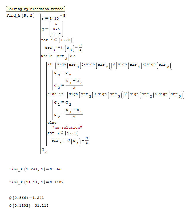

Solving by the old bisection method:
contact stress calc_by_bisection.sm (26,36 КиБ) скачан 1308 раз(а).

Solving with a custom algorithm.
contact stress calc_2.sm (21,66 КиБ) скачан 1332 раз(а).

#9 Опубликовано: 25.10.2022 12:08:25
Oscar Campo
Oscar Campo
Very elegant!
