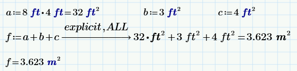

Hey Andrey, I'm still very interested in this feature, and I think a lot of people are also.
MathCAD Prime 10.0 has this:
The only problem is MathCAD won't let you hide the "explicit, ALL" text on the formula. It really makes the calculations look crowded and messy.
It would be amazing if SMath could do something similar, but make it better.
Is it a matter of funding?
