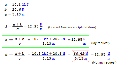

I know, this is a feature that has been requested over and over, and over, with many attempts by lots of users to produce a similar outcome. Most of these don't work very well, or are at best extremally tedious use in any practical sense and do not make it easier than just manually doing the substitution.
It seems like this request never really moves forward, and I'm not sure why, since it is always being asked for. I've seen similar requests from as far back as 11 years.
We really need an additional type of optimization.
The current optimization options do not provide for a means to achieve this outcome.

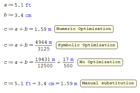

The only current way to make it work is to manually write the formula with the values and units in it, but this totally defeats the point of having a powerful program like SMath!
I can do manual calcs on paper without any programs...
All that is needed is for the display of the initial substitution, with the user defined units, before the final result is shown.
We don't need the formula evaluated with the user defined units, we only need the substitution displayed in the format of the expressed formula, that's it!
Like this:
It's totally fine if the default result is in default units, the user can manually define other units as needed.

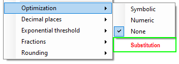

I think it makes sense to have this as an additional type of optimization, perhaps called "Substitution"?
It would be the same as numeric, since you still need the formula evaluated, but it would only display the initial substitution before the final result.

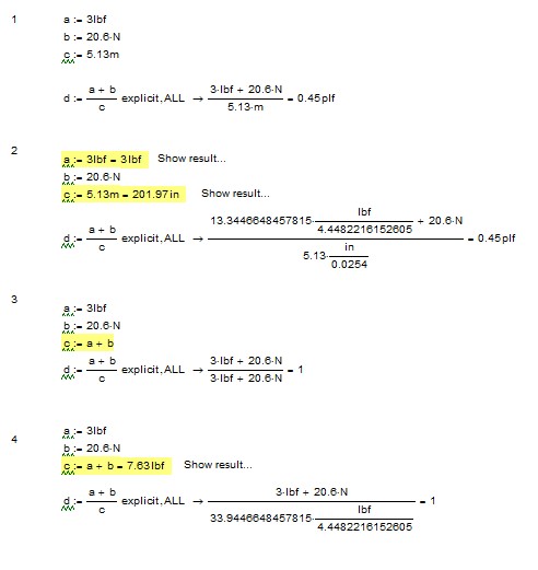

I see three scenarios:
1. Any "variable" that is not "user defined/displayed" (g.e in this example) is not shown in the substitution, since there is nothing to substitute that is being displayed.
g.e is not "displayed" before the equation, but "a" is.
2. If g.e is "displayed", in this case with default units, then it is shown in the substitution as such.
3. We can also "redefine" the units of g.e and this "new" definition is what is shown in the substitution.
Note that the units for the result of "b" can be changed to a user defined unit. If "b" was "defined/displayed" as lbf, then the next time it is called into an equation, the substitution will show what was displayed for the result/definition.
We are simply showing what is being "defined/displayed", however you want to describe it. The system will always default to the default units, this is fine. Users can decide what units they want to see, and this "definition/display" is what should be in the substitution display. It is still a regular Numerical optimization, but with a view of the variables substituted into their place.
Does this make sense?

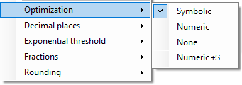

Maybe we should call this new optimization Numerical+ or Numerical+S?

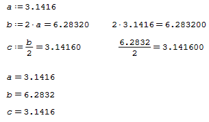

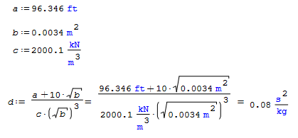

Just to clarify what I mean when I say I don't want/need "intermediate results".
I don't need SMath to show me algebra and arithmetic steps.
Note: The default output unit for this example is m*Pa, I just changed it for a cleaner look.

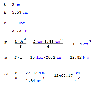

Exactly, now we are on the same page. I also agree that we need to separate the definition and display of substitutions, as you have called it. I think the storage definition is going to be much harder than just the display.
Here is a visual of your example:

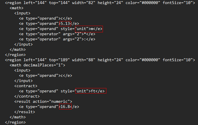

As for the display for the variables, you can see it right in the html code. Both the user defined units, and the number of decimal places are there.
Remember, we are talking only about the display of the variables substituted into the defined equation exactly as they are displayed before the equation. In the background, the evaluation is still numeric as before.

You can assign whatever units you want to each calculation individually. Default units are just for calculations in the background. You can even change in which units the result is displayed.
As I showed before, both the decimal places and the units that are displayed are part of the html code. So these "definitions" as we might call them, should be able to be recalled as such, and substituted and displayed in the format of the equation they are placed into.

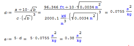

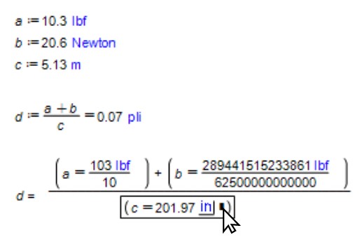

Here is an example of a nonsense equation that is a bit more complex in its formatting.
As you can see, c has only 1 decimal place, while a and b have 3. The default decimal place setting is 2.
So when the calculation of d is performed, the result is shown with only 2 decimal places, because of the default setting. I can change that if I want.
The variables are displayed in the format of the equation exactly as they are previously displayed.

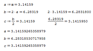

Lets say that I decide to show the result of d with 4 decimal places instead of 2, and then I use it in a new equation, d will be shown with 4 as it is shown just before the equation.

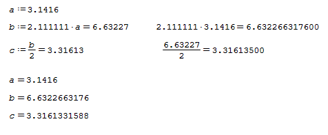

As far as I understand, unless you activate significant figures, SMath is running full precision in background regardless of how you display the results.

Significant figures or decimal places are just two ways to format the result. I guess they should not affect the background calculation, otherwise we would go back to the times of the slide rule and accumulate round-off errors.
I absolutely agree with what you displayed, thanks for illustrating my statements.
Are the reviewers fine with the possible difference between full precision background result and a result obtained from using truncated substitutions?
Isn't this no different than how things are now? If you define a variable out to 15 decimal places, the calculations will carry that precision through. If you define it only to 4 decimal places, then 4 is all you can get. In the end you can chose to display values differently than how SMath is using them in the calculations. Even when you get a result from an equation. That result has a level of precision that is determined by the level of precision of the variables/numbers used in the equation. You can still chose to display 2 or whatever decimals you can.
In this example, pi is defined out to 15 decimal places, I am choosing to display only 5 decimal places, but the calculation is being done with the full 15. On the side is the direct substitution calculation with the numbers as displayed. As you can see, it produces different results.
Now in this example, I have defined pi only to 4 decimal places. With trailing zeros on, you can see that the calculation is limited by the 4 decimal places I have defined.
When we mix "accuracy" we see that we get a total combined level of precision. 6+4=10.
So I'm not sure it would be any different for what I'm asking for. The calculation would still be done as before, just like any other numerically optimized calculation. Even the final result would be the same as before. You would chose how to display it, but the calculations are being done to full possible precision.
I have no idea how this would be done if you want to show step by step simplifications of equations (which is not what I'm looking for). That seems like a much bigger/harder problem to solve.
