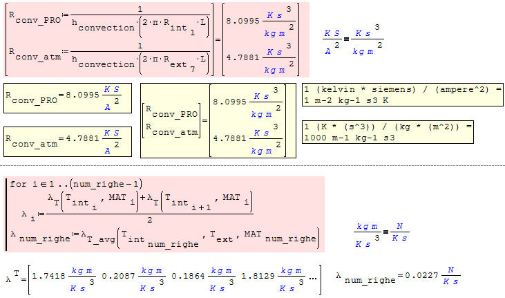

#2 Опубликовано: 18.06.2018 21:42:24
Honestly, I'm lost in there. The project is so messy, it lacks sound preparation.
Your Rint 0 generates "division by zero" easy to imagine that Rint may not be
exactly 0 ... 10^-12 is very close to 0.
On the other hand, the while loop must be "Numeric" NOT Optimiz
Also, part of the while loop does not like Units.
My Smath version 6179
Would be wise to work unitless.
Will be back ... Jean

I didn't really get a chance to go through the math at all, but I did optimize run time of the current implementation. I used the eval() function in the lamda_t function definition. Took evaluation from 20 seconds to 0.25 seconds on my machine.
PROVA CONDUZIONE TERMICA_bkp_alyles.sm (65,88 КиБ) скачан 1281 раз(а).

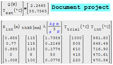

#8 Опубликовано: 19.06.2018 21:17:04
CBG
CBG
A small modification
PROVA CONDUZIONE TERMICA_bkp_CBG.sm (224,77 КиБ) скачан 1341 раз(а).
#9 Опубликовано: 20.06.2018 10:39:03
Thanks Carlos for doctoring this project.
1. Refreshed a bit
2. Few more things at the end.
3. "L" is confusing as not explained ... considered "unary"
4. Two pests [in green] wrt to units.
5. The last 4 "clear" removed from program [avoid red]
Wait and see for Originator to comment/complement
PROVA CONDUZIONE TERMICA_bkp_CBG [Jean].sm (344,38 КиБ) скачан 1146 раз(а).

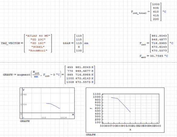

#10 Опубликовано: 20.06.2018 11:29:01
#11 Опубликовано: 20.06.2018 12:13:05
... maybe the last brick in the wall, if so desired:
I'm only slightly pregnant of understanding the discontinuity
@ [770] ... infinitesimal film is not discontinuous.
Easy to fillet, Hermite tool box will do.

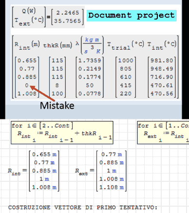

I think there is an error in the internal radios.

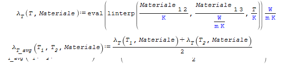

I will review all the contributions one by one, I just had the chance right now to go through the posts now quickly..
The use of eval() is somehow new to me, I will look at it's implications, since I understand that it has improved a lot the execution time.
Yesterday morning I spent some minutes again testing my file and became suspicious at how I implemented lambda.
It looks like I was accessing to that database matrix a lot of time.
Now I see that a great improvement has come from this eval() function...
Will go through the details and keep you posted.

Hello Jean
Thanks Carlos: my mistake from copy/paste, delete 'm'
Forgot the unit system bug that does not output 0m, 1m.
That bug was reported long time ago, may have corrected in 6671.

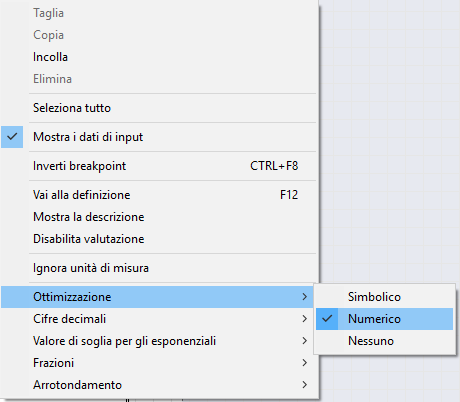

Ok, I took my time to study all the files you posted and read all the replies again and again.
I'm happy to see that the "while" was messy, not commented properly, etc etc... but it could work (with some help)!
And also the lambda function and the way I defined the database...
First of all, going to your contributions, now I see what Jean meant with one of the first replies:
I needed to right click and set the while to Numerical optimization?
Setting my original file this way, makes the loop work quickly (shame on me, I wasn't even aware of such setting...)
Also Alyses hint has helped me to understand that the symbolic evaluation was the problem, and that some different setting should be implemented.
... I did optimize run time of the current implementation. I used the eval() function in the lamda_t function definition...
Iinfact, the following files by other users did not use the eval() function, so I was kind of lost, until I found that right click setting...
So, in the end, if my understanding is correct, eval() and right-click numeric optimization setting are equivalent, isn't it?

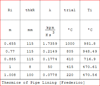

#16 Опубликовано: 20.06.2018 22:03:18
ean, what command are you using to generate this kind of matrix? What is the sintax, I mean,to define Q(w) or T.ext (°c) and obtain results without Units? Looks like it is a Custom Function again.
That, mon ami, is too simple doing ... like this:
1. from the matrix palette, insert a 2 rows by 5 cols
2. in 2nd row, paste results from above results,
backspace on units Rint ... bacspace on all 'm'
3. in 1rst row, type trial(Alt+248C) => trial(°C)
4. λ(,) ... kg*m/s^3*K from result above
This type of matrix project collection is natural, fast
and fully accessible by more maths from other demands.
It has nothing to do with the plugin "Table region"

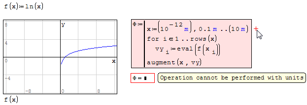

About your other question: optimiz mode, eval there is no clear 1/1 answer.
In some advanced maths, the RHS , i.e: the function must be set in eval(,) mode.
Observe: Genfit Rational Type J_6
1. Minimize(XY,f,φ,β) .... some eval(,) within overall numeric
2. φ(x,β,f,n) ... strictly symbolic
3. eval(Φ^-1)*d ... eval(,) within numeric
The λ(,) is 1/1 similar to the LMTD [Log Mean Temperature Difference]
otherwise related to diameters ratio. I found no maths from suppliers.
Cheers Frederico ... Jean
Genfit Rational Type J_6.sm (61,98 КиБ) скачан 1240 раз(а). ... stuff about eval(,)

#17 Опубликовано: 20.06.2018 23:16:50
Not so simple !
In the just attached Hermite Polyline, open the first collapsed area.
Observe eval(,) in the subspace module, this is a case of local definition.
#18 Опубликовано: 21.06.2018 13:18:42
... Data Table added. No problem to construct and display.
Couldn't reduce the height of the two first rows ... Ah !
Project PROVA CONDUZIONE TERMICA_bkp_CBG [Jean].sm (402,64 КиБ) скачан 1148 раз(а).
