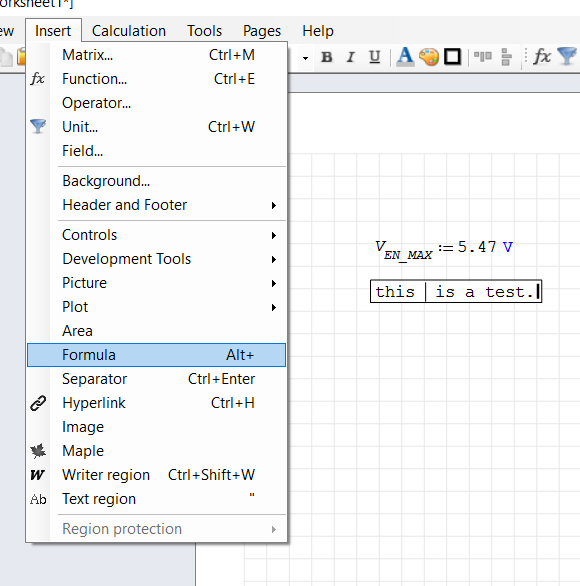

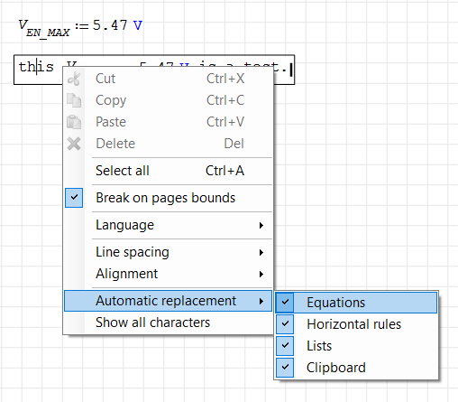

#7 Опубликовано: 12.03.2022 03:40:59
Let me know if there are questions or if these steps don't work for people.
The steps above work, nothing is wrong with those items.
And now there is a simpler way to write formulas in text regions.
If equation replacement is enabled for that particular text region,
you can insert > formula and directly write anything math involded.
And it will be evaluated and changed according to variable value.
So you won't need to copy/paste everything.

#9 Опубликовано: 12.03.2022 13:59:12
João Felipe Seráfico Melo
7 сообщений из 62 понравились пользователям.
That feature is amazing! For how long has it been available? Brand new stuff for me.
