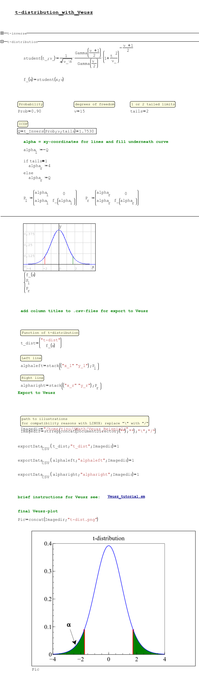

For all Linux users which unfortunately can't use the prize winning (gratuliere Kay ) Maxima plugin
for graphics, here a more serious and hopefully better documented example of a Veusz-plot.
To ensure compatibility between Windows and Linux, the screenshots in the tutorial have been included as png-images.
Hint: Text-regions which appear garbled due to the known SMath-bug under Linux can, at least teporarily,
be fixed by typing any letter and deleting it again.
