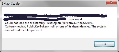

Have enjoyed using this as a successor to the commercial product which it seems to work like. I created a sheet in the XMCD format earlier, and now it is unable to open in the new version. Following is the information in the error dialogue that comes
.XMCD
Could not load file or assembly 'TextRegion, Version=1.9.4868.42191,
Culture=neutral, PublicKeyToken=null' or one of its dependencies. The system
cannot find the file specified.
The program does load, and is able to create a NEW sheet; as far as I can tell it works all right, just simply cannot load the existing .XMCD format file.

Fixed. Will be available in the next version.

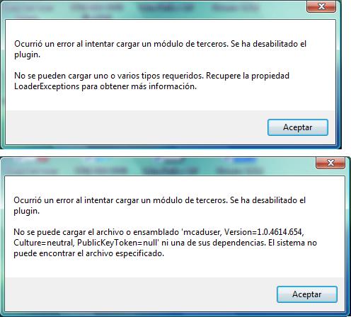

Andrey, this is an amazing job you have done with this program! I have a problem when I start SMath: apparently it can not load a group of plugin because it can't find the file 'mcaduser, version= 1.04614.654'. I don't konw it this problem is mine or a bug. Thank you.
#4 Опубликовано: 02.05.2013 18:27:30
1 547 сообщений из 1 861 понравились пользователям.
This is my problem. Mathcad EFI plugin doesn't work in the new version. So, it must be removed. Remove two files: mcaduser.dll and mcadefi.dll.
