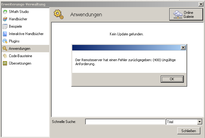

I cannot access the applications from the online gallery, neither in the installer version nor in the (otherwise reliable) portable one.

Fixed. The issue was on server-side (at smath.info). Appeared for those who used many installed plug-ins. No SMath Studio update required.
