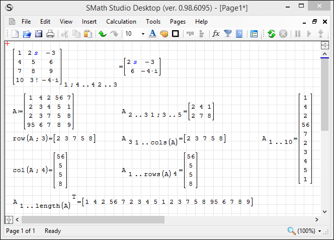

  • Added ability to retrieve submatrix of specified rows and columns using ranges within el(..) function;

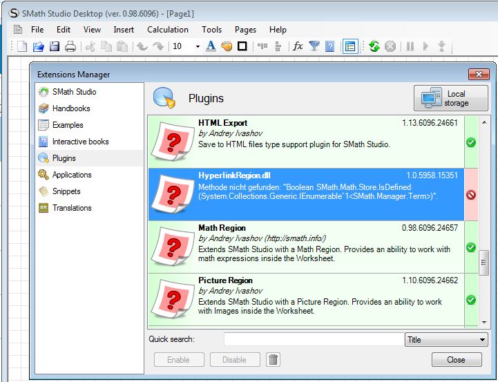

The plugin Hyperlink Region fails to install in the portable version (linux version + portable.version file).
The remove (dustbin) button does not work (plugin remains in the list)

#5 Опубликовано: 11.09.2016 18:14:44
2 343 сообщений из 4 044 понравились пользователям.
Группа: Super Administrator
Martin, thank you!
I've finally reproduced issue you have mentioned. It happened because you have put not supported HyperlinkRegion.dll version directly into plugins directory.
  • First of all, Hyperlink Region ver. 1.0.5958.15351 not supported by latest version of SMath Studio. You have to use beta version (please see http://en.smath.info/view/HyperlinkRegion for the link).
  • Second, plugins directory designed to support only plug-ins which are 100% compatible with current version of SMath Studio (usually you can find only built-in plig-ins). All others are better to put under extensions\plugins\\\, even if we are talking about portable version. But be aware, in addition to such a complex path config..ini must be available under extensions\plugins\\ and it should contain a text with version (i.e. folder) of the plug-in to use.
Regarding item 2: to understand it properly just try to install any plug-in using Extensions Manager and then go to extensions folder next to SMath Studio EXE (if portable.version exists) or to %APPDATA%\SMath\extensions (otherwise).
So, if you will correct location of the HyperlinkRegion.dll (and other plug-ins manually put into plugins folder) issue will gone.
