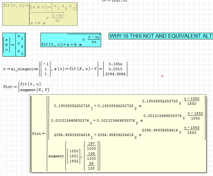

Razonar first gave me this formalism for al_nleqsolve. His formalism works perfectly; however, mine does not.
Here is my example SMATH file.
AL_NLEQSOLVE FIT.sm (20,48 КиБ) скачан 1761 раз(а).
Sorry, I forgot to upload the data file. Here it is.
WORLD EMISSION DATA VS DATE.xlsx (24,74 КиБ) скачан 1306 раз(а).

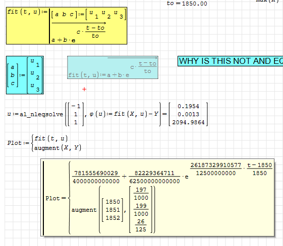

Two questions:
1. How can the plot of f(t,u) work because t is never defined?
2. I don't understand why my alternate formalism in the cyan box is not equivalent.

#2 Опубликовано: 13.02.2025 08:36:48
Hi Reg. You can see the result stored in Plot by hovering over it. In the case of the first option, Plot stores a one-variable expression (i.e., a single unknown, t) and a two-column matrix, so the graphs will be a univariate function and a set of points on the plane.
To analyze the second option, the nleqsolve set up is correct, but Plot fails to find the values ​​of a,b,c inside the fit function.
As a final comment, XY Plot can graph expressions with any unknown, while SMath's native plot can also do so, but only with the variable "x".
I hope this clarifies a little why the second option doesn't work.

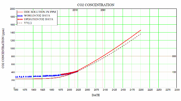

... Infrequently, SMATH crashes on me. It may be my 10 year old computer. When I include a separator in my file, and then try to move it with the mouse, it totally destroys all of my graph settings to the point that I have to delete the graphs and start over. This is how I move areas; so I thought I could move the separator the same way. If I add and delete spaces with the cursor and my keyboard that works fine. So, I have stopped using separators.
On my Windows too, on 32 and 64 bit machines. If I want to move an area, I collapse it, cut it and paste it to the desired destination.
My version has a discrepancy with yours, although I don't understand where it could be: I check them and according to me they should be the same. (Area in yellow)
CO2 FORCING SATURATION STUDY 2.sm (116,6 КиБ) скачан 1861 раз(а).
CO2 FORCING SATURATION STUDY 2.pdf (634,17 КиБ) скачан 1128 раз(а).

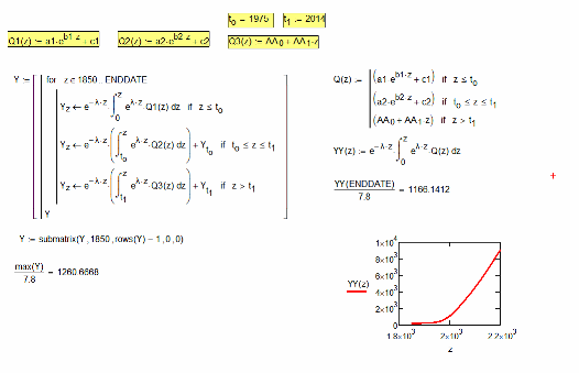

I can only assume it is differences in the order of calculation between the two methods. Note that there is a slight difference between u.lin1 and u.lin2 in our versions. I assume it is the difference in how we define the subset of data between 2014 and 2023.
I have attached a pdf of my MATHCAD file that supposedly does the same calculation. There are small differences here also, but they manifest in a rather large difference in the result when the emission model reaches 1.5 °C. MATHCAD predicts 2128 and SMATH predicts 2120 for the same input constants…I think.
But we physicists usually do estimates to an order of magnitude. We are very happy with a factor of two. Our difference of 1233.2524/1156.6686 =1.07 makes us ecstatic.
MATHCAD CO2 FORCING.pdf (603,43 КиБ) скачан 1163 раз(а).

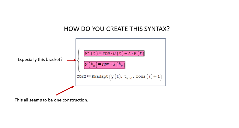

Alvaro,
Two things;
1. How do you create this syntax for Rkadapt.
2. Your integral over tk is equal to my Y as far as I can tell.
CO2 FORCING SATURATION STUDY NEW.sm (599,66 КиБ) скачан 1930 раз(а).
I have tried numerous things, but I still don't understand the difference in the two methods.

FYI,
MATHCAD produces the same discrepancy between the two integral methods.
Reg
Reg CurryLoveland, CO

... 1. How do you create this syntax for Rkadapt. ...
It is the syntax for an ode solver using the "Mathcad toolbox"
... 2. Your integral over tk is equal to my Y as far as I can tell.
Thank you for confirming that I am not making some basic mistake, at least the mistake is somewhat hidden, in case there is one. If it were a derivative, one can expect anything, since it is a very unstable numerical procedure, but when it comes to integrals it is supposed to be stable and robust. What's more, it is supposed to be continuous on the right, but one can always find examples that complicate things.
