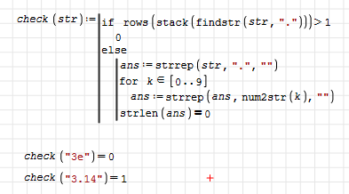

Hi. This could be a way for positive numbers.
check.sm (4 КиБ) скачан 19 раз(а).

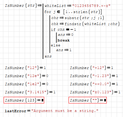

Here is a less compact solution, can be adapted to accept different characters.
(Positive/negative values can be allowed with an additional condition on the first character)

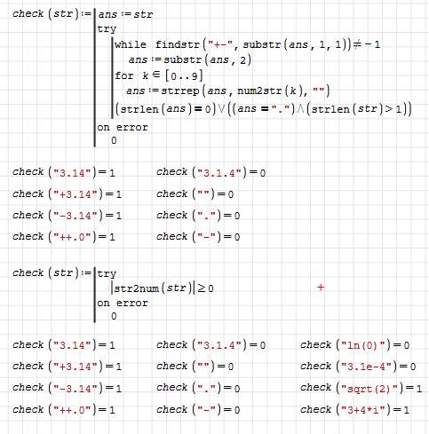

#4 Опубликовано: 06.12.2023 21:54:14
Alvaro Diaz Falconi
Alvaro Diaz Falconi
992 сообщений из 1674 понравились пользователям.
Signed numbers allowed. Also, compared with str2num results.

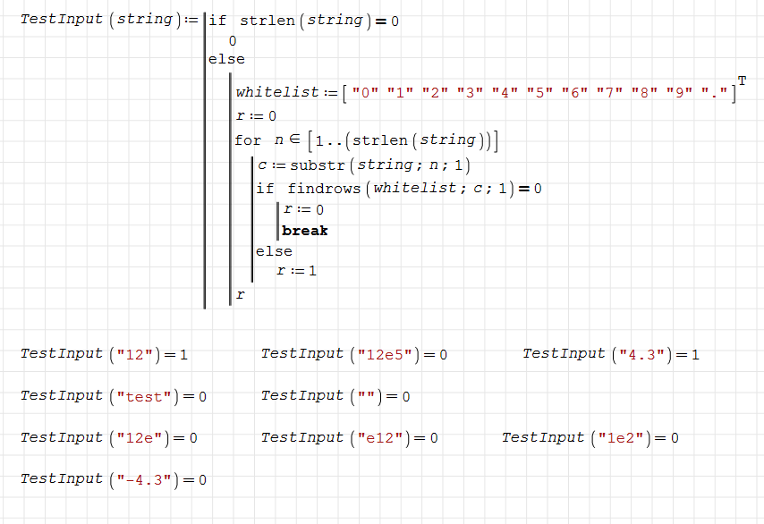

#5 Опубликовано: 07.12.2023 03:16:07
547 сообщений из 1330 понравились пользователям.
Near identical to Davide, this is how I would do it.
At least this is what I have done in QBasic long ago.
IsNumber.sm (7 КиБ) скачан 24 раз(а).

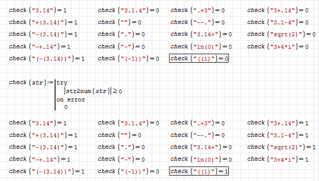

#7 Опубликовано: 09.12.2023 03:55:37
Alvaro Diaz Falconi
Alvaro Diaz Falconi
Hi. Parenthesis added. Notice that the plus/minus sign must to be only at the first's places, but with parenthesis it is not more true. And it looks like SMath's str2num have a bug: str2num(" ((1)" ) is wrong.
