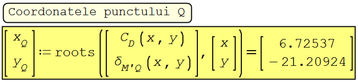

Trying to analytically solve a practical matter, I came to the sophistry in the attached file. Maybe someone knows what the causes are.Sophism.sm (29,3 КиБ) скачан 1683 раз(а).

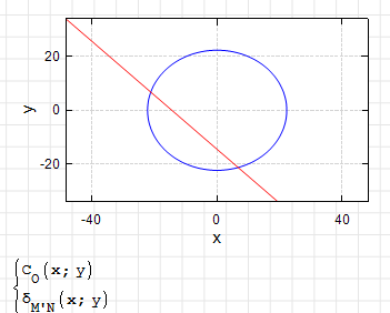

#2 Опубликовано: 20.07.2023 09:14:20

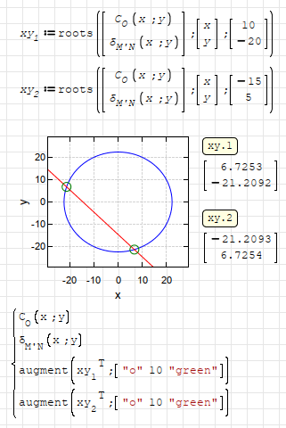

Good! You tell me that there are two solutions. I agree! But in this case the roots(2) function should mention them as such. In addition, the other intersection has coordinates x=-6.72537 and y=+21.20924. As a result, I (as a technician with a specialty other than mathematics) am confused. I understand that the other solution, I have to enter it from the console, in the case of a complicated and automated calculation?! My request is that you show me another method of calculation, which will offer me a solution automatically applicable to the case in question. Automatically, meaning without my intervention from the console.
#4 Опубликовано: 20.07.2023 10:40:50
Since Smath Studio ... has been replaced by Smath Solver,
lots of Studio projects don't work anymore.
Page 1 of this document solves line/intersection/circle.
Further down red complains. Slope/Intercept are kaput Solver.
You can rescue from the numerical code ... page 6
Eventually, you can solve any f(x,y), F(x,y) intersection(s).
Hope it helps ... Jean.
Solve Circle Line Intersect Normal.sm (170,83 КиБ) скачан 1667 раз(а).
#5 Опубликовано: 20.07.2023 10:57:17
roots(3) solves intersection(s) of two symbolic differentiable functions.
Initialize wisely the third argument of roots(3)
#6 Опубликовано: 20.07.2023 11:18:20
Good! You tell me that there are two solutions. I agree! But in this case the roots(2) function should mention them as such. In addition, the other intersection has coordinates x=-6.72537 and y= 21.20924. As a result, I (as a technician with a specialty other than mathematics) am confused. I understand that the other solution, I have to enter it from the console, in the case of a complicated and automated calculation?! My request is that you show me another method of calculation, which will offer me a solution automatically applicable to the case in question. Automatically, meaning without my intervention from the console.
Previously explained.
#7 Опубликовано: 20.07.2023 11:32:29
This is why we have roots(3).
Solving without plotting is bad exercise.
You may have full, correct and single answers without guesses for some equations.
But sometimes you are gonna need to plot equations, find intersections and their coordinates.
If you determine good guess points, it will show you nearest results to that coordinates.

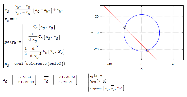

#9 Опубликовано: 20.07.2023 16:42:03
Hi Nicolas.
Not in this case, because SMath's solve is a numerical procedure. You can demand that of maple's solve() or Maxima's Solve() .
Not that fast ... the values for x are +6.7253 and -21.2093.
Although I think that overlord's solution shows the correct solution, this other method does not require initial values, since it makes use of the knowledge that the solution implies a quadratic equation, assuming that the line M'N is not vertical .
Sophism.sm (35,61 КиБ) скачан 1663 раз(а).

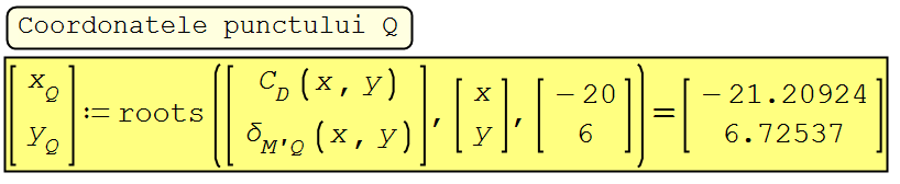

#11 Опубликовано: 21.07.2023 08:31:00
Nicolae Olaru
Nicolae Olaru
1 сообщений из 115 понравились пользователям.
With a suitable pair of guess values, the problem will always indicate the pair of variables of the considered point, as can be seen in the attachment. Thanks for the guidance.Image_.png
