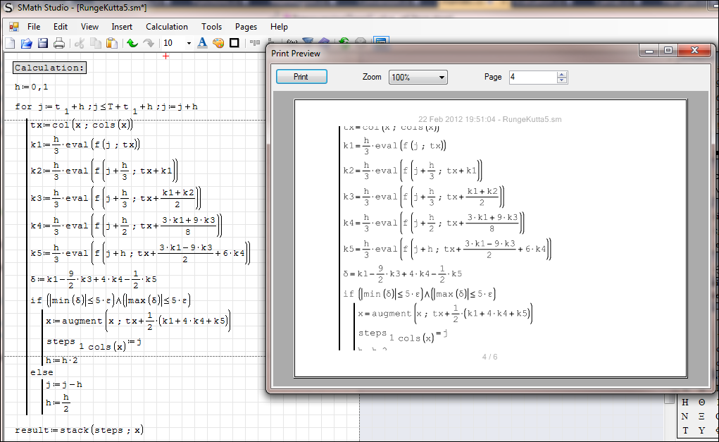

A problem with printing I had encountered on previous versions of SMath is if a region is bigger than a page, Print and Print Preview would lock up. Maybe a long function or matrix. Just a head up. Otherwise this is one of the features I was hoping for to pretty up my calculations. Good job.
Ed
Yep, this error was one of the reasons of printing reimplementation. Now you can print any kind of regions of any size.
