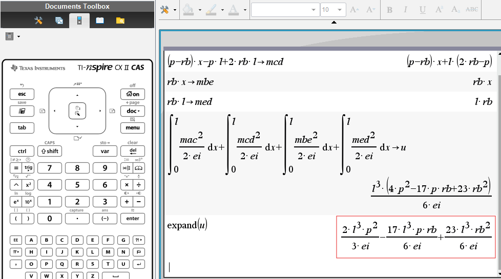

Hi. I'm using Ti Nspire cx cas. And I knew this wonderful smath studio program!
In Ti Nspire, when I want to expand a equation, I use expand() function.
But in smath studio, I couldn't find expand() function.
How can I do this, for example, the equation is
(x+y+z)^6

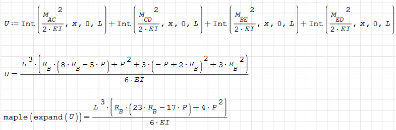

Thank you very much. I could expand my equation like below.
one more question please..
Can I expand it in smath studio like in my Ti nspire result?
