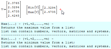

More generally:
#6 Опубликовано: 29.01.2018 20:13:54
Min/min ... Max/max are 2/4 different animals.
2D Plot Discontinuous [min(,)].sm (13,56 КиБ) скачан 997 раз(а).
