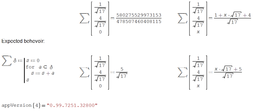

#4 Опубликовано: 06.07.2020 03:45:56
Hi. Thanks Overlord. I don't see these other problem. What make troubles for me is the fact that sum don't returns the symbolic values but numerical approximations, in this case for sqrt(17). I expect to see sum(vec) = 5/sqrt(17) instead the rational showed. I introduce the "x" value just for check if sum have some eval() function somewhere. But then ... ups, another issue simplifying 1+4.
#5 Опубликовано: 06.07.2020 04:00:32
sum.sm (11,67 КиБ) скачан 1535 раз(а).

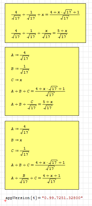

#6 Опубликовано: 06.07.2020 07:17:28
I see no bug ...
NOBUG.sm (30,88 КиБ) скачан 1470 раз(а).

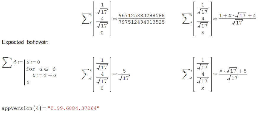

#7 Опубликовано: 06.07.2020 12:48:31
Hi. Some notes attached.
sum.sm (20,39 КиБ) скачан 1477 раз(а).
sum.pdf (66,13 КиБ) скачан 842 раз(а).
