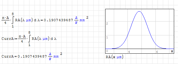

#4 Опубликовано: 08.01.2013 12:59:36
gfggirardi
gfggirardi
Thank you very much for your answer,
I've attached a file that's explaining the error that I get.
resource1.sm (13,04 КиБ) скачан 1441 раз(а).
#5 Опубликовано: 08.01.2013 13:14:02
This should be correct (I hope...)
#6 Опубликовано: 08.01.2013 14:42:35
kilele
kilele
Good point:
If your function involves units you must specify units on the independent variables when calling the function.
Edit:
Anyway on my sample the integral seems problematic dealing with units, since it should return square meters.
Edit2:
Sorry for the confussion, the integral works fine here!
I wanted to assign units to the result taking into account the geometrical interpretation of line integral, similarly Callmeishmael referred to units for the physical meaning of velocity.
Davide Carpi 09.01.2013 08:44:00

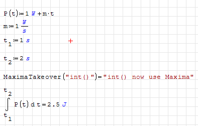

#8 Опубликовано: 12.11.2014 15:02:20
zapzapouch
zapzapouch
0 сообщений из 27 понравились пользователям.
Good point:
I don't understand. If you have a constant power dissipation of 1 W for 1 second, you will consume 1 J of energy. To write this in integral form: [see attached image]
int(1 W, dt, 1 sec, 2 sec) should equal 1 W * (2 sec - 1 sec) = 1 J
So why can't we use units in the limits of the integral?

#10 Опубликовано: 12.11.2014 17:13:44
zapzapouch
zapzapouch
So you're basically removing the units before the integral and then re-adding them after it's done? What does LE stand for and why is it blue like a unit for you? It's not for me.
#11 Опубликовано: 13.11.2014 03:32:05
brotjob
brotjob
7 сообщений из 71 понравились пользователям.
The approach posted by PompelmoTell is now obsolete. Do like in the example attached.
To create your own units you start with an apostroph: 'LE gives you the blue colour.
#12 Опубликовано: 13.11.2014 12:33:13
zapzapouch
zapzapouch
..assuming you have the Maxima plugin installed and Maxima installed?
