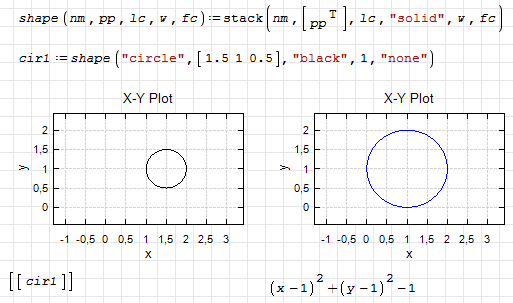

Hi. Without doubts Viacheslav use of him plugin is the better solution. But here some examples about how to setup the plot of a parametric curve using native SMath plots.
circle.sm (30,39 КиБ) скачан 1233 раз(а).

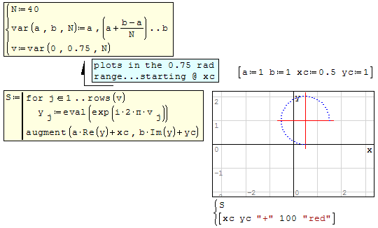

WroteFrom native maths in native Smath.
... code it as a generalized companion utility.
Circle Complex.sm (14,32 КиБ) скачан 1197 раз(а).
Wrote... code it as a generalized companion utility.
... enjoy the magic circle aperture.
Circle Magic Disk.sm (16,83 КиБ) скачан 1255 раз(а).
