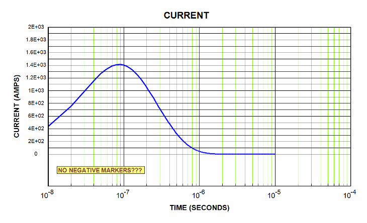

In the following ZedGraph, there are no major scaler markers in the negative y axis region. Have I missed an important parameter in setting up the graph?
ZEDGRAPH QUESTION.sm (38,86 КиБ) скачан 1752 раз(а).
Thanks,
Reg

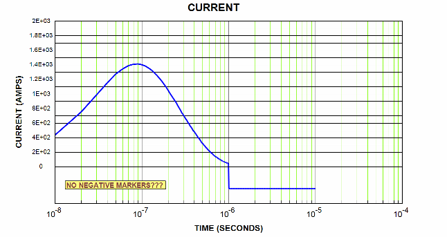

Hi Alvaro,
The vertical scale is set to linear.
I fixed the later time values to -300.

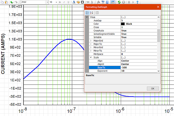

Oh, yes! You're right. I see "E" and think in logs. Please modify this parameter:
RegC 27.02.2025 13:54:00
